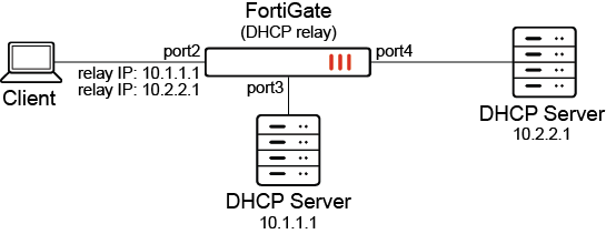

Example
In this example, two DHCP relay servers are configured on port2, with DHCP relay IP addresses 10.1.1.1 and 10.2.2.1.
To configure the DHCP relay servers:
config system interface
edit "port2"
set dhcp-relay-service enable
set dhcp-relay-ip 10.1.1.1 10.2.2.1
