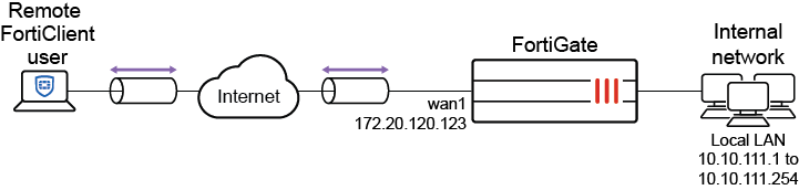

This is a sample configuration of dialup IPsec VPN with FortiClient as the dialup client.
You can configure dialup IPsec VPN with FortiClient as the dialup client using the GUI or CLI.

To configure IPsec VPN with FortiClient as the dialup client on the GUI:
  1. Configure a user and user group.
    1. Go to User & Authentication > User Definition to create a local user vpnuser1.
    2. Go to User & Authentication > User Groups to create a group vpngroup with the member vpnuser1.
  2. Go to VPN > IPsec Wizard and configure the following settings for VPN Setup:
    1. Enter a VPN name.
    2. For Template Type, select Remote Access.
    3. For Remote Device Type, select Client-based > FortiClient.
    4. Click Next.
  3. Configure the following settings for Authentication:
    1. For Incoming Interface, select wan1.
    2. For Authentication Method, select Pre-shared Key.
    3. In the Pre-shared Key field, enter your-psk as the key.
    4. From the User Group dropdown list, select vpngroup.
    5. Click Next.
  4. Configure the following settings for Policy & Routing:
    1. From the Local Interface dropdown menu, select lan.
    2. Configure the Local Address as local_network.
    3. Configure the Client Address Range as 10.10.2.1-10.10.2.200.
    4. Keep the default values for the Subnet Mask, DNS Server, Enable IPv4 Split tunnel, and Allow Endpoint Registration.
    5. Click Next.
  5. Adjust the Client Options as needed, then click Create.
  6. Optionally, define a unique Peer ID in the phase1 configuration:
    1. Go to VPN > IPsec Tunnels and edit the just created tunnel.
    2. Click Convert To Custom Tunnel.
    3. In the Authentication section, click Edit.
    4. Under Peer Options, set Accept Types to Specific peer ID.
    5. In the Peer ID field, enter a unique ID, such as dialup1.
    6. Click OK.
The DNS suffix can be configured in the phase 1 configuration using the command set domain <string> .This feature is available only in IKE version 1 and requires enabling unity-support using in the Phase 1 configuration. See IPsec DNS suffix for more information.
To configure IPsec VPN with FortiClient as the dialup client using the CLI:
  1. In the CLI, configure the user and group.
    config user local
        edit "vpnuser1"
            set type password
            set passwd your-password
    config user group
        edit "vpngroup"
            set member "vpnuser1"
  2. Configure the internal interface. The LAN interface connects to the corporate internal network. Traffic from this interface routes out the IPsec VPN tunnel. Creating an address group for the protected network behind this FortiGate causes traffic to this network group to go through the IPsec tunnel.
    config system interface
        edit "lan"
            set vdom "root"
            set ip 10.10.111.1 255.255.255.0
    config firewall address
        edit "local_subnet_1"
            set subnet 10.10.111.0 255.255.255.0
        edit "local_subnet_2"
            set subnet 10.10.112.0 255.255.255.0
    config firewall addrgrp
        edit "local_network"
            set member "local_subnet_1" "local_subnet_2"
  3. Configure the WAN interface. The WAN interface is the interface connected to the ISP. It can work in static mode (as shown in this example), DHCP, or PPPoE mode. The IPsec tunnel is established over the WAN interface.
        edit "wan1"
            set vdom "root"
            set ip 172.20.120.123 255.255.255.0
  4. Configure the client address pool. You must create a firewall address to assign an IP address to a client from the address pool.
        edit "client_range"
            set type iprange
            set comment "VPN client range"
            set start-ip 10.10.2.1
            set end-ip 10.10.2.200
  5. Configure the IPsec phase1-interface. In this example, PSK is used as the authentication method. Signature authentication is also an option.
        edit "for_client"
            set type dynamic
            set interface "wan1"
            set mode aggressive
            set peertype one
            set peerid "dialup1"
            set net-device enable
            set mode-cfg enable
            set proposal aes128-sha256 aes256-sha256 aes128-sha1 aes256-sha1
            set dpd on-idle
            set xauthtype auto
            set authusrgrp "vpngroup"
            set assign-ip-from name
            set ipv4-name "client_range"
            set dns-mode auto
            set ipv4-split-include "local_network"
            set save-password enable
            set psksecret your-psk
            set dpd-retryinterval 60
  6. Configure the IPsec phase2-interface.
        edit "for_client"
            set phase1name "for_client"
            set proposal aes128-sha1 aes256-sha1 aes128-sha256 aes256-sha256 aes128gcm aes256gcm chacha20poly1305
  7. Configure the firewall policy to allow client traffic flow over the IPsec VPN tunnel.
    config firewall policy
            set name "inbound"
            set srcintf "for_client"
            set dstintf "lan"
            set srcaddr "client_range"
            set dstaddr "local_network"
            set service "ALL"
Tooltip
One or more user groups for user authentication can be configured under a single IPsec VPN tunnel. See Using single or multiple user groups for user authentication for details.
To configure FortiClient:
  1. In FortiClient, go to Remote Access and click Add a new connection.
  2. Set the VPN to IPsec VPN and the Remote Gateway to the FortiGate IP address.
  3. Set the Authentication Method to Pre-Shared Key and enter the key.
  4. Expand Advanced Settings > Phase 1 and in the Local ID field, enter dialup1.
  5. Configure remaining settings as needed, then click Save.
  6. Select the VPN, enter the username and password, then select Connect.
        edit "wan1"
            set vdom "root"
