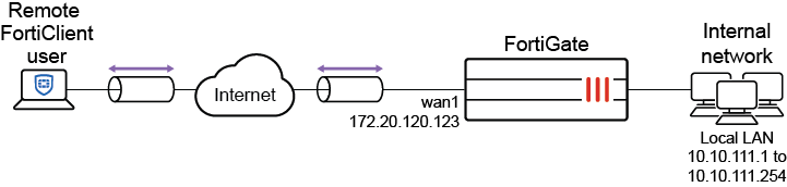

This is a sample configuration of dialup IPsec VPN with FortiClient as the dialup client.
You can configure dialup IPsec VPN with FortiClient as the dialup client using the GUI or CLI.

  2. Configure the internal interface. The LAN interface connects to the corporate internal network. Traffic from this interface routes out the IPsec VPN tunnel. Creating an address group for the protected network behind this FortiGate causes traffic to this network group to go through the IPsec tunnel.
    config system interface
        edit "lan"
            set vdom "root"
            set ip 10.10.111.1 255.255.255.0

  3. Configure the WAN interface. The WAN interface is the interface connected to the ISP. It can work in static mode (as shown in this example), DHCP, or PPPoE mode. The IPsec tunnel is established over the WAN interface.
        edit "wan1"
            set vdom "root"
            set ip 172.20.120.123 255.255.255.0

To configure FortiClient:
  1. In FortiClient, go to Remote Access and click Add a new connection.
  2. Set the VPN to IPsec VPN and the Remote Gateway to the FortiGate IP address.
  3. Set the Authentication Method to Pre-Shared Key and enter the key.
  4. Expand Advanced Settings > Phase 1 and in the Local ID field, enter dialup1.
  5. Configure remaining settings as needed, then click Save.
  6. Select the VPN, enter the username and password, then select Connect.
