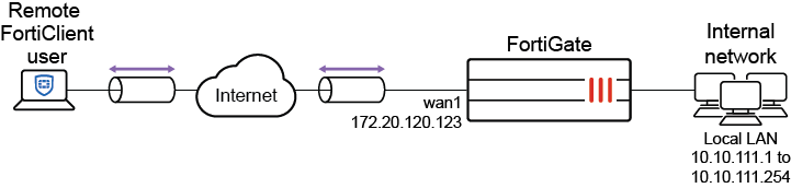

This is a sample configuration of dialup IPsec VPN with FortiClient as the dialup client.
You can configure dialup IPsec VPN with FortiClient as the dialup client using the GUI or CLI.

To configure IPsec VPN with FortiClient as the dialup client on the GUI:
  1. Configure a user and user group.
    1. Go to User & Authentication > User Definition to create a local user vpnuser1.
    2. Go to User & Authentication > User Groups to create a group vpngroup with the member vpnuser1.
  2. Go to VPN > IPsec Wizard and configure the following settings for VPN Setup:

            set member "local_subnet_1" "local_subnet_2"
  3. Configure the WAN interface. The WAN interface is the interface connected to the ISP. It can work in static mode (as shown in this example), DHCP, or PPPoE mode. The IPsec tunnel is established over the WAN interface.
    config system interface
        edit "wan1"
            set vdom "root"
            set ip 172.20.120.123 255.255.255.0
  4. Configure the client address pool. You must create a firewall address to assign an IP address to a client from the address pool.
    config firewall address
        edit "client_range"
            set type iprange
            set comment "VPN client range"
            set start-ip 10.10.2.1
            set end-ip 10.10.2.200
  5. Configure the IPsec phase1-interface. In this example, PSK is used as the authentication method. Signature authentication is also an option.
        edit "for_client"
            set type dynamic
            set interface "wan1"
            set mode aggressive
            set peertype one
            set peerid "dialup1"
            set net-device enable
            set mode-cfg enable
            set proposal aes128-sha256 aes256-sha256 aes128-sha1 aes256-sha1
            set dpd on-idle
            set xauthtype auto
            set authusrgrp "vpngroup"
            set assign-ip-from name
            set ipv4-name "client_range"
            set dns-mode auto
            set ipv4-split-include "local_network"
            set save-password enable
            set psksecret your-psk
            set dpd-retryinterval 60
  6. Configure the IPsec phase2-interface.
        edit "for_client"
            set phase1name "for_client"
            set proposal aes128-sha1 aes256-sha1 aes128-sha256 aes256-sha256 aes128gcm aes256gcm chacha20poly1305
  7. Configure the firewall policy to allow client traffic flow over the IPsec VPN tunnel.
    config firewall policy
            set name "inbound"
            set srcintf "for_client"
            set dstintf "lan"
            set srcaddr "client_range"
            set dstaddr "local_network"
            set service "ALL"
Tooltip
One or more user groups for user authentication can be configured under a single IPsec VPN tunnel. See Using single or multiple user groups for user authentication for details.
To configure FortiClient:
  1. In FortiClient, go to Remote Access and click Add a new connection.
  2. Set the VPN to IPsec VPN and the Remote Gateway to the FortiGate IP address.
  3. Set the Authentication Method to Pre-Shared Key and enter the key.
  4. Expand Advanced Settings > Phase 1 and in the Local ID field, enter dialup1.
  5. Configure remaining settings as needed, then click Save.
  6. Select the VPN, enter the username and password, then select Connect.
