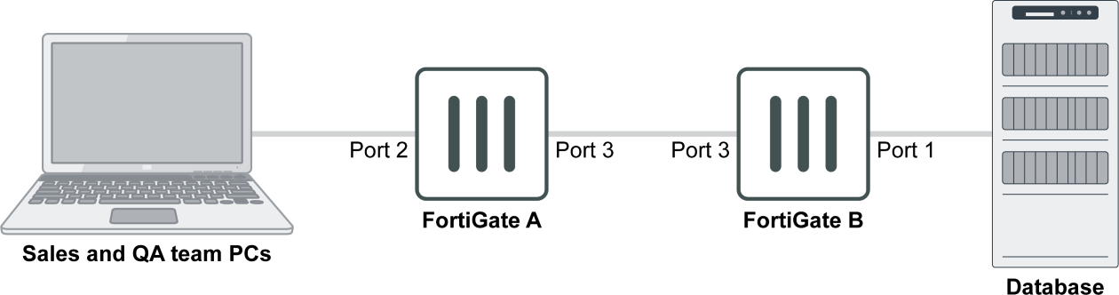

Examples
Example 1
FortiGate A marks traffic from the sales and QA teams with different DSCP values. FortiGate B does DSCP matching, allowing only the sales team to access the database.

Example 2
FortiGate A marks traffic from the sales and QA teams with different DSCP values. FortiGate B uses a firewall shaping policy to do the DSCP matching, limiting the connection speed of the sales team to the database to 10MB/s.

Example 3
FortiGate A has a traffic shaping policy to mark traffic from the QA team with a DSCP value of 100000, while reverse traffic is marked with 000011.
