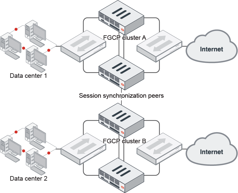

Synchronizing sessions between FGCP clusters
Synchronizing sessions between FGCP clusters is useful when data centers in different locations are used for load-balancing, and traffic must be shared and flow freely based on demand.

To configure session synchronization between two clusters:
- Configure the two clusters (see HA active-passive cluster setup or HA active-active cluster setup).
- On cluster A, configure the peer IP for the interface:
config system interface edit "port5" set vdom "root" set ip 10.10.10.1 255.255.255.0 set allowaccess ping https ssh snmp http telnet next endIn this example, cluster A uses port5 and its IP address, 10.10.10.1, is reachable from another cluster.
- On cluster A, configure cluster and session synchronization:
config system cluster-sync edit 1 set peerip 10.10.10.2 next end - On cluster A, configure additional FGSP attributes as needed:
config system standalone-cluster set standalone-group-id 1 set group-member-id 0 set session-sync-dev <interface> endThe
standalone-group-idmust match between FGSP members. Thegroup-member-idis unique for each FGCP cluster.session-sync-devis an optional command to specify the interfaces to sync sessions. - On cluster B, configure the peer IP for the interface:
config system interface edit "port5" set vdom "root" set ip 10.10.10.2 255.255.255.0 set allowaccess ping https ssh snmp http telnet next endIn this example, cluster B uses port5 and its IP address, 10.10.10.2, is reachable from another cluster.
- On cluster B, configure cluster and session synchronization:
config system cluster-sync edit 1 set peerip 10.10.10.1 next end - On cluster B, configure additional FGSP attributes as needed:
config system standalone-cluster set standalone-group-id 1 set group-member-id 1 set session-sync-dev <interface> end
