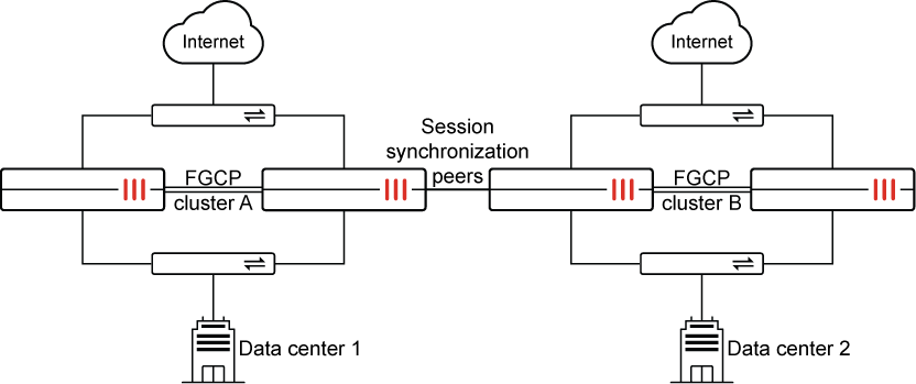

Synchronizing sessions between FGCP clusters is useful when data centers in different locations are used for load balancing, and traffic must be shared and flow freely based on demand.

To configure session synchronization between two clusters:

    In this example, cluster A uses port5 and its IP address, 10.10.10.1, is reachable from another cluster.

    The standalone-group-id must match between FGSP members. The group-member-id is unique for each FGCP cluster. session-sync-dev is an optional command to specify the interfaces to sync sessions.
