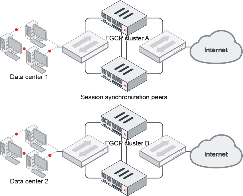

Synchronizing sessions between FGCP clusters
Synchronizing sessions between FGCP clusters is useful when data centers in different locations are used for load balancing, and traffic must be shared and flow freely based on demand.

To configure session synchronization between two clusters:
- Configure the two clusters (see HA active-passive cluster setup or HA active-active cluster setup).
- On cluster A, configure the peer IP for the interface:
config system interface edit "port5" set vdom "root" set ip 10.10.10.1 255.255.255.0 set allowaccess ping https ssh snmp http telnet next endIn this example, cluster A uses port5 and its IP address, 10.10.10.1, is reachable from another cluster.
- On cluster A, configure FGSP, including cluster and session synchronization:
config system standalone-cluster set standalone-group-id 1 set group-member-id 0 set session-sync-dev <interface> config cluster-peer edit 1 set peerip 10.10.10.2 next end endThe
standalone-group-idmust match between FGSP members. Thegroup-member-idis unique for each FGCP cluster.session-sync-devis an optional command to specify the interfaces to sync sessions. - On cluster B, configure the peer IP for the interface:
config system interface edit "port5" set vdom "root" set ip 10.10.10.2 255.255.255.0 set allowaccess ping https ssh snmp http telnet next endIn this example, cluster B uses port5 and its IP address, 10.10.10.2, is reachable from another cluster.
- On cluster B, configure FGSP, including cluster and session synchronization:
config system standalone-cluster set standalone-group-id 1 set group-member-id 1 set session-sync-dev <interface> config cluster-peer edit 1 set peerip 10.10.10.1 next end end
