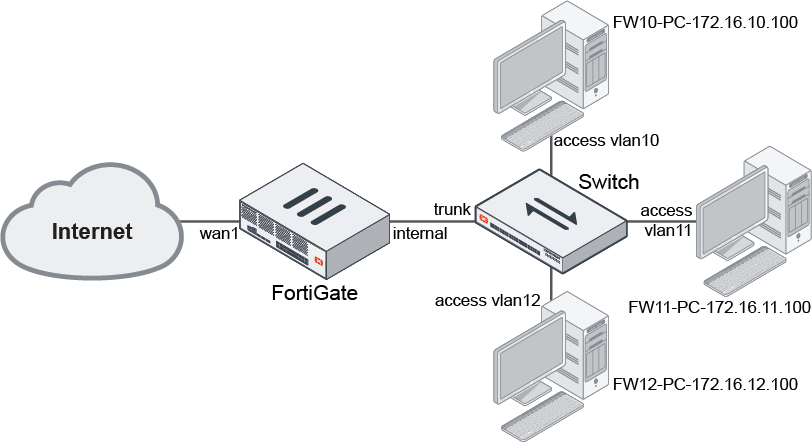

Physical topology:

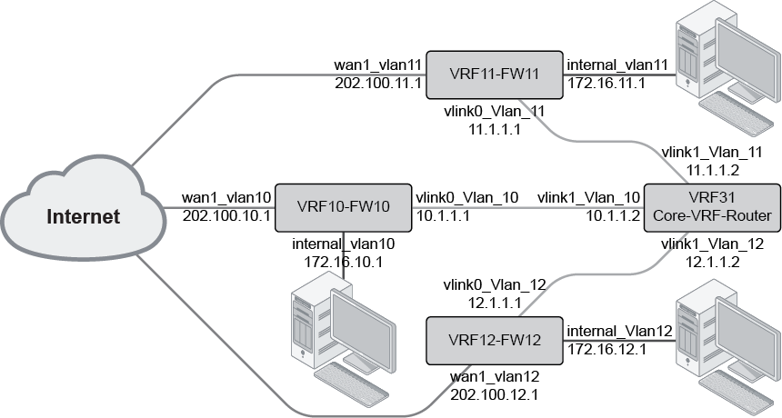

Logical topology:
In this example, a specific route is leaked from each of the VRFs to each of the other VRFs. VLAN subinterfaces are created based on VDOM links to connect each VRF to the core VRF router.
