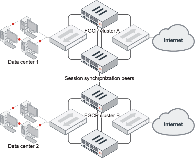

Synchronizing sessions between FGCP clusters is useful when data centers in different locations are used for load balancing, and traffic must be shared and flow freely based on demand.
There are some limitations when synchronizing sessions between FGCP clusters:
  • All FortiGates must have the same model and generation, hardware configuration, and FortiOS version.
  • A total of 16 clusters can share sessions.
To configure session synchronization between two clusters:
  1. Configure the two clusters (see HA active-passive cluster setup or HA active-active cluster setup).
  2. On cluster A, configure the peer IP for the interface:
    config system interface
        edit "port5"
            set vdom "root"
            set ip 10.10.10.1 255.255.255.0
            set allowaccess ping https ssh snmp http telnet
    In this example, cluster A uses port5 and its IP address, 10.10.10.1, is reachable from another cluster.
  3. On cluster A, configure FGSP, including cluster and session synchronization:
    config system standalone-cluster
        set standalone-group-id 1
        set group-member-id 0
        set session-sync-dev <interface>
        config cluster-peer
                set peerip 10.10.10.2
    The standalone-group-id must match between FGSP members. The group-member-id is unique for each FGCP cluster. session-sync-dev is an optional command to specify the interfaces to sync sessions.
  4. On cluster B, configure the peer IP for the interface:
        edit "port5"
            set vdom "root"
            set ip 10.10.10.2 255.255.255.0
    In this example, cluster B uses port5 and its IP address, 10.10.10.2, is reachable from another cluster.
  5. On cluster B, configure FGSP, including cluster and session synchronization:
        set group-member-id 1
        config cluster-peer
                set peerip 10.10.10.1
