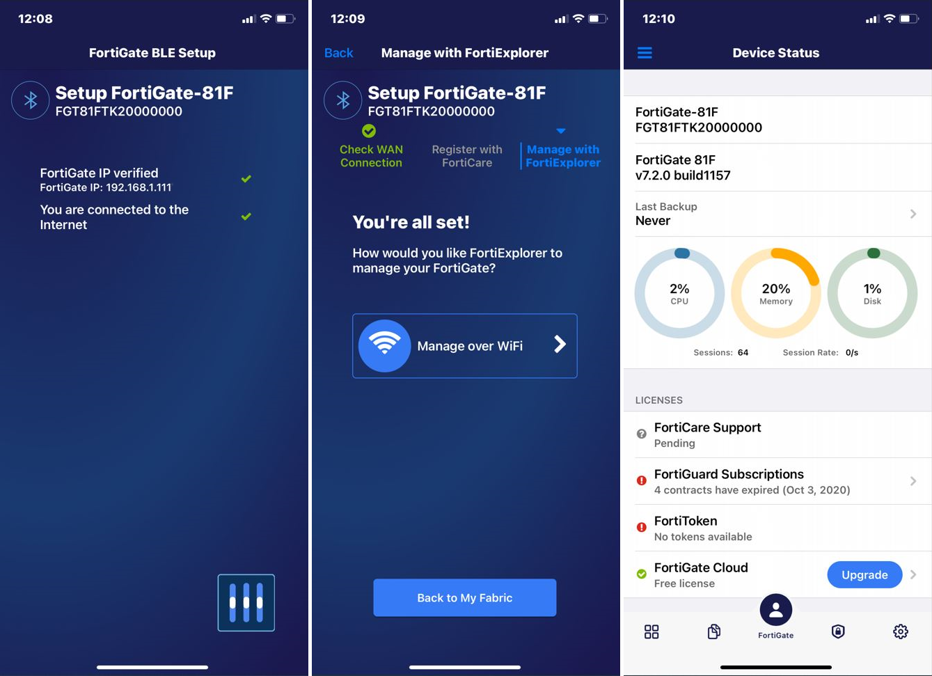

To connect to and configure a FortiGate with FortiExplorer using BLE:

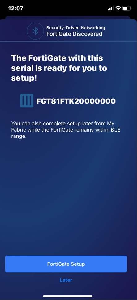

  1. Ensure that BLE is enabled on the FortiGate device.
  2. Enable Bluetooth on your iOS device and open the FortiExplorer app.
    If the app has detected the FortiGate device, the device's serial number will be shown.

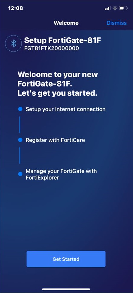

  3. Log into the FortiGate in the app using the default credentials: admin and no password.
  4. If this is the first time logging into the device, set a password.
  5. Optionally, register with FortiCare.
  6. Configure the FortiGate, including the WAN and internal interfaces, static routes, and other required settings.
    After configuring the FortiGate and disconnecting, BLE is disabled.
