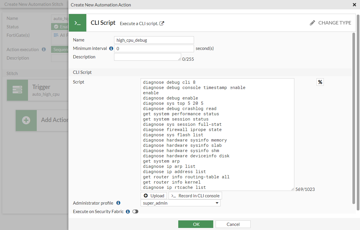

- Configure the CLI Script action:
- Click Add Action.
- Click Create and select CLI Script.
- Enter the following:
Name
high_cpu_debug
Script
diagnose debug cli 8 diagnose debug console timestamp enable diagnose debug enable diagnose sys top 5 20 5 diagnose debug crashlog read get system performance status get system session status diagnose sys session full-stat diagnose firewall iprope state diagnose sys flash list diagnose hardware sysinfo memory diagnose hardware sysinfo slab diagnose hardware sysinfo shm diagnose hardware deviceinfo disk get system arp diagnose ip arp list diagnose ip address list get router info routing-table all get router info kernel diagnose ip rtcache list

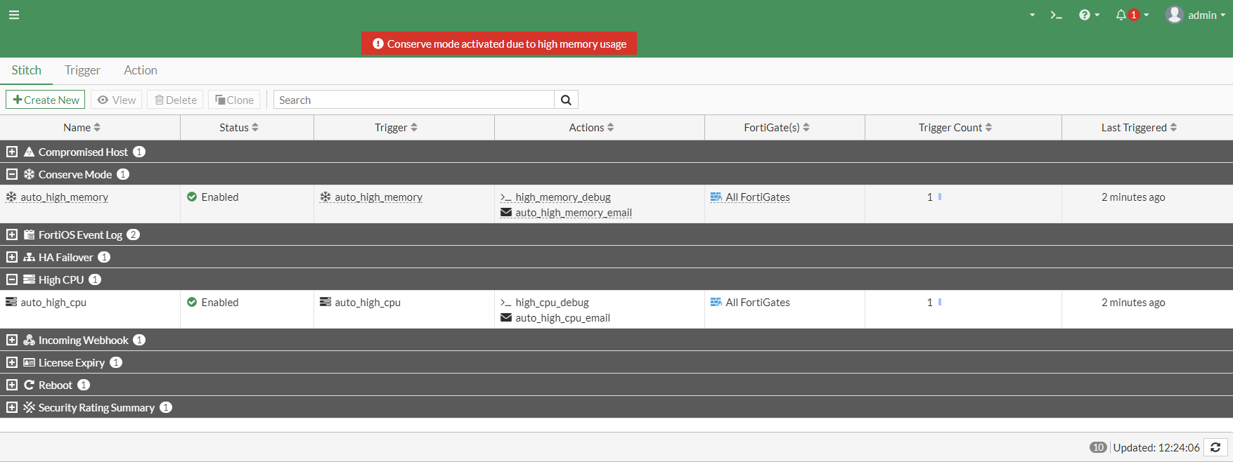

Results
When the FortiGate enters conserve mode due to the memory-use-threshold-red being exceeded, the GUI displays a notice, and the auto_high_memory automation stitch is triggered. This causes the CLI script to run and the script results are emailed to the specified address.
Here is sample text from the email message:
CSF stitch alert: high_memory noreply@notification.fortinet.net Thu 11/21/2019 11:06 AM John Doe FGT[FGVM16TM19000000] Automation Stitch:auto_high_memory is triggered. ########## script name: autod.47 ########## ========== #1, 2019-11-21 11:07:24 ========== FGVM16TM19000000 $ diag deb cli 8 Debug messages will be on for 25 minutes. FGVM16TM19000000 $ diag deb console timestamp enable FGVM16TM19000000 $ diag deb enable FGVM16TM19000000 $ diag deb crashlog read 1: 2019-08-08 11:35:25 the killed daemon is /bin/dhcpcd: status=0x0 2: 2019-08-08 17:52:47 the killed daemon is /bin/pyfcgid: status=0x0 3: 2019-08-23 11:32:31 from=license status=INVALID 4: 2019-08-23 11:32:32 from=license status=INVALID 5: 2019-11-21 09:53:31 from=license status=VALID ...
