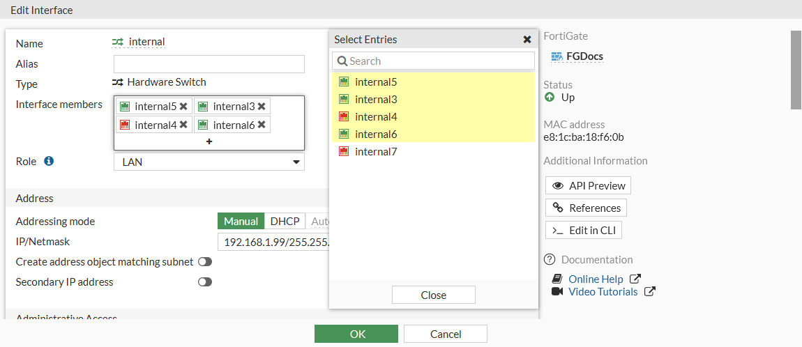

To change the ports in a hardware switch in the GUI:
- Go to Network > Interface and edit the hardware switch.
- Click inside the Interface members field.
- Select interfaces to add or remove them from the hardware switch, then click Close.
To add an interface to a hardware switch, it cannot be referenced by an existing configuration and its IP address must be set to 0.0.0.0/0.0.0.0.
- Click OK.
Removed interfaces will now be listed as standalone interfaces in the Physical Interface section.
