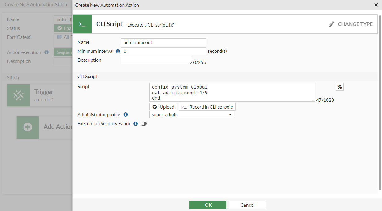

- Configure the CLI Script action:
- Click Add Action.
- Click Create and select CLI Script.
- Enter the following:
Name
admintimeout
Script
config system global set admintimeout 479 endAlternatively, click Upload to upload a file, or click >_Record in CLI console and enter the CLI commands.
Administrator profile
Select a profile
- Click OK.

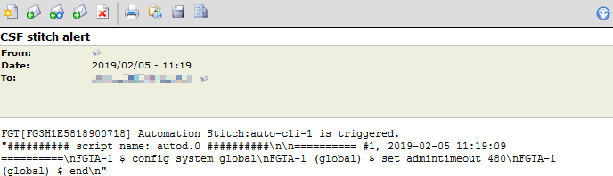

Sample email
The email sent by the action will look similar to the following:
