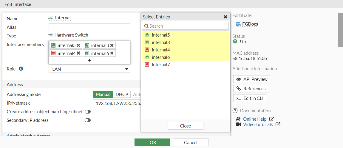

To change the ports in a hardware switch in the GUI:
- Go to Network > Interface and edit the hardware switch.
- Click inside the Interface members field.
- Select interfaces to add or remove them from the hardware switch, then click Close.
To add an interface to a hardware switch, it cannot be referenced by an existing configuration and its IP address must be set to 0.0.0.0/0.0.0.0.
- Click OK.
Removed interfaces will now be listed as standalone interfaces in the Physical Interface section.

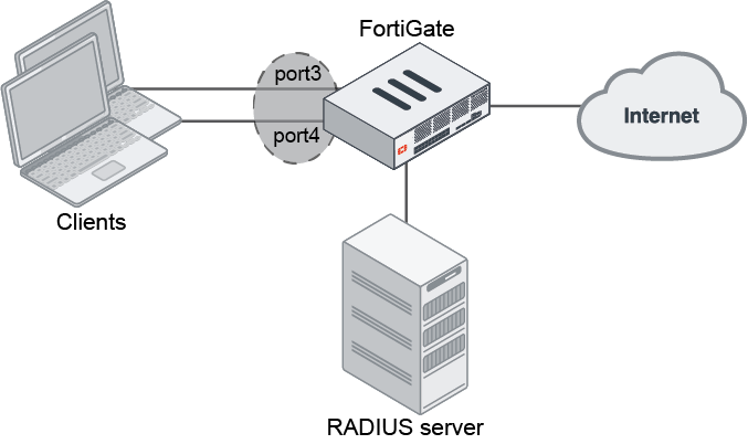

Using 802.1X on virtual switches for certain NP6 platforms
802.1X is supported under the hardware switch interface on the following NP6 platforms: FG-30xE, FG-40xE, and FG-110xE.
In this example, port3 and port4 are part of a hardware switch interface. The hardware switch acts as a virtual switch so that devices can connect directly to these ports and perform 802.1X authentication on the port.
Prerequisites:
- Configure a RADIUS server (see RADIUS servers).
- Define a user group named test to use the remote RADIUS server and for 802.1X authentication (see User definition, groups, and settings).
- Configure a hardware switch (named 18188) with port3 and port4 as the members.
- Configure a firewall policy that allows traffic from the 18188 hardware switch to go to the internet.
- Enable 802.1X authentication on the client devices.
To configure 802.1X authentication on a hardware switch in the GUI:
- Go to Network > Interfaces and edit the hardware switch.
- In the Network section, enable Security mode and select 802.1X.
- Click the + to add the User group.
- Click OK.
To configure 802.1X authentication on a hardware switch in the CLI:
- Configure the virtual hardware switch interfaces:
config system virtual-switch edit "18188" set physical-switch "sw0" config port edit "port3" next edit "port4" next end next end - Configure 802.1X authentication:
config system interface edit "18188" set vdom "vdom1" set ip 1.1.1.1 255.255.255.0 set allowaccess ping https ssh snmp fgfm ftm set type hard-switch set security-mode 802.1X set security-groups "test" set device-identification enable set lldp-transmission enable set role lan set snmp-index 52 next end
To verify the that the 802.1X authentication was successful:
- Get a client connected to port3 to authenticate to access the internet.
- In FortiOS, verify the 802.1X authentication port status:
# diagnose sys 802-1x status Virtual switch '18188' (default mode) 802.1x member status: port3: Link up, 802.1X state: authorized port4: Link up, 802.1X state: unauthorized
