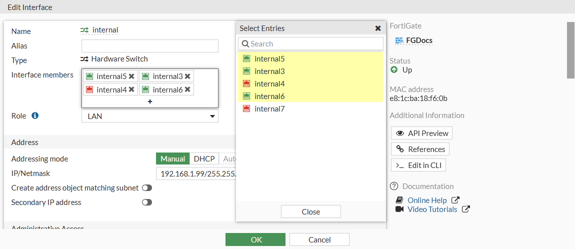

To change the ports in a hardware switch in the GUI:
- Go to Network > Interface and edit the hardware switch.
- Click inside the Interface members field.
- Select interfaces to add or remove them from the hardware switch, then click Close.
To add an interface to a hardware switch, it cannot be referenced by an existing configuration and its IP address must be set to 0.0.0.0/0.0.0.0.
- Click OK.
Removed interfaces will now be listed as standalone interfaces in the Physical Interface section.

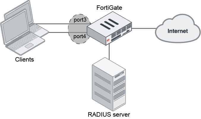

In this example, port3 and port4 are part of a hardware switch interface. The hardware switch acts as a virtual switch so that devices can connect directly to these ports and perform 802.1X authentication on the port.
Prerequisites:
- Configure a RADIUS server (see RADIUS servers).
- Define a user group named test to use the remote RADIUS server and for 802.1X authentication (see User definition and groups).
- Configure a hardware switch (named 18188) with port3 and port4 as the members.
- Configure a firewall policy that allows traffic from the 18188 hardware switch to go to the internet.
- Enable 802.1X authentication on the client devices.

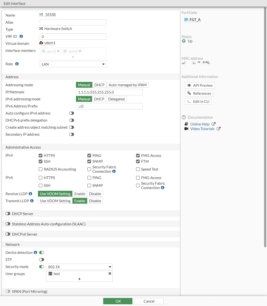

To configure 802.1X authentication on a hardware switch in the GUI:
- Go to Network > Interfaces and edit the hardware switch.
- In the Network section, enable Security mode and select 802.1X.
- Click the + to add the User group.
- Click OK.
