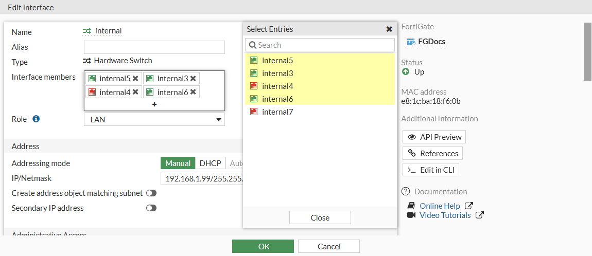

To change the ports in a hardware switch in the GUI:
Go to Network > Interface and edit the hardware switch.
Click inside the Interface members field.
Select interfaces to add or remove them from the hardware switch, then click Close.
To add an interface to a hardware switch, it cannot be referenced by an existing configuration and its IP address must be set to 0.0.0.0/0.0.0.0.
Click OK.
Removed interfaces will now be listed as standalone interfaces in the Physical Interface section.

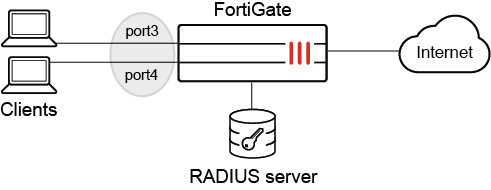

Example of using 802.1X on virtual switches
In this example, port3 and port4 are part of a hardware switch interface. The hardware switch acts as a virtual switch so that devices can connect directly to these ports and perform 802.1X authentication on the port.
Prerequisites:
Configure a RADIUS server (see RADIUS servers).
Define a user group named test to use the remote RADIUS server and for 802.1X authentication (see User definition, groups, and settings).
Configure a hardware switch (named 18188) with port3 and port4 as the members.
Configure a firewall policy that allows traffic from the 18188 hardware switch to go to the internet.
Enable 802.1X authentication on the client devices.

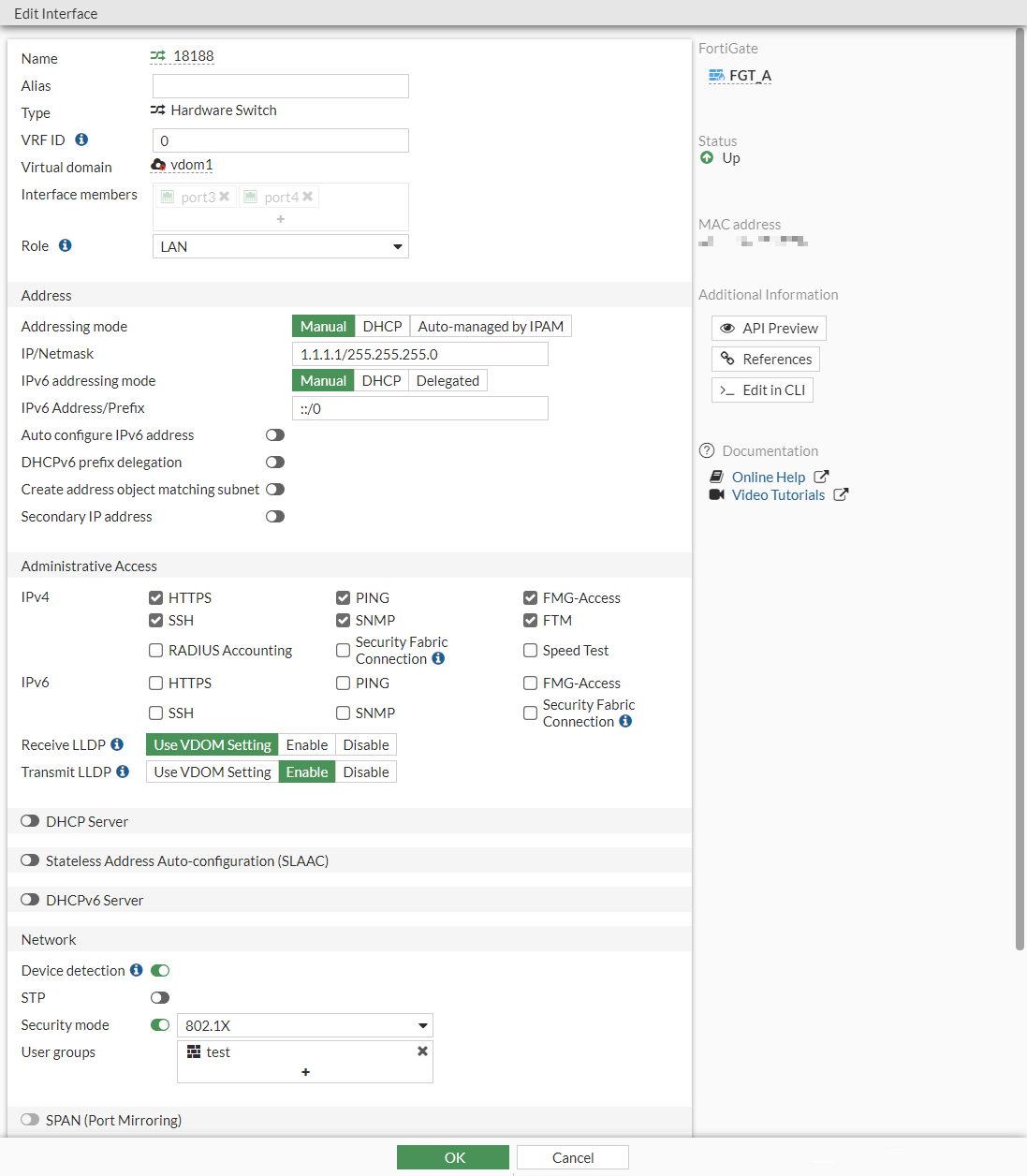

To configure 802.1X authentication on a hardware switch in the GUI:
Go to Network > Interfaces and edit the hardware switch.
In the Network section, enable Security mode and select 802.1X.
Click the + to add the User group.
Click OK.
