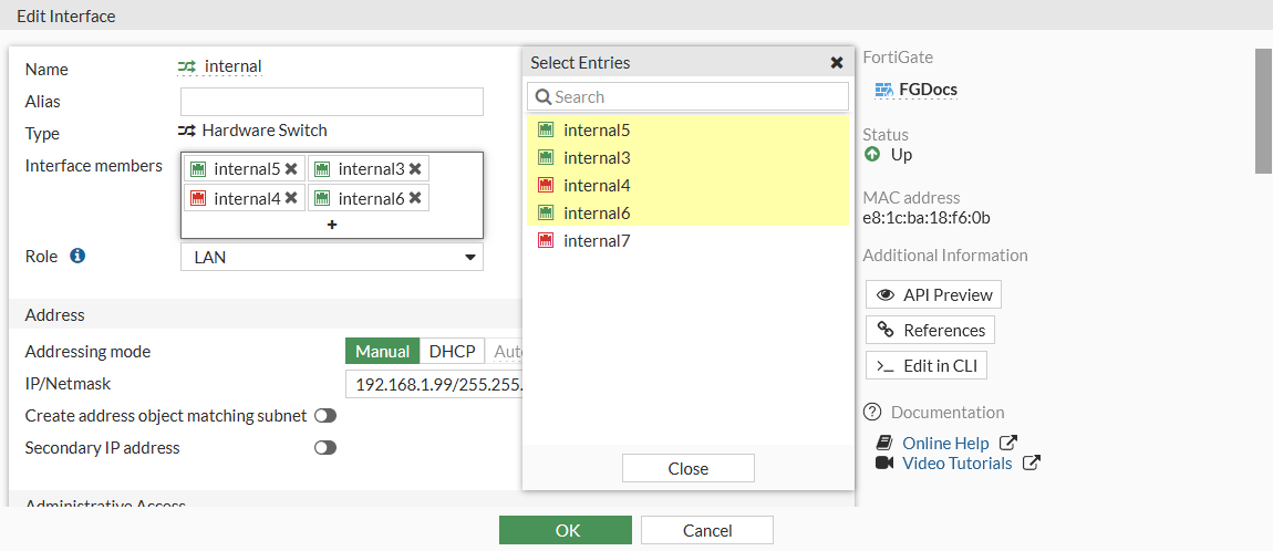

To change the ports in a hardware switch in the GUI:
  1. Go to Network > Interface and edit the hardware switch.
  2. Click inside the Interface members field.
  3. Select interfaces to add or remove them from the hardware switch, then click Close.
    To add an interface to a hardware switch, it cannot be referenced by an existing configuration and its IP address must be set to 0.0.0.0/0.0.0.0.
  4. Click OK.
    Removed interfaces will now be listed as standalone interfaces in the Physical Interface section.

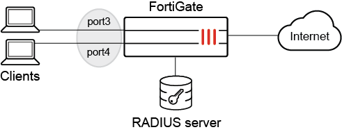

In this example, port3 and port4 are part of a hardware switch interface. The hardware switch acts as a virtual switch so that devices can connect directly to these ports and perform 802.1X authentication on the port.
Prerequisites:
  1. Configure a RADIUS server (see RADIUS servers).
  2. Define a user group named test to use the remote RADIUS server and for 802.1X authentication (see User definition, groups, and settings).
  3. Configure a hardware switch (named 18188) with port3 and port4 as the members.
  4. Configure a firewall policy that allows traffic from the 18188 hardware switch to go to the internet.
  5. Enable 802.1X authentication on the client devices.

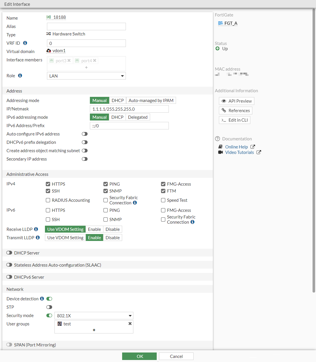

To configure 802.1X authentication on a hardware switch in the GUI:
  1. Go to Network > Interfaces and edit the hardware switch.
  2. In the Network section, enable Security mode and select 802.1X.
  3. Click the + to add the User group.
  4. Click OK.
  4. Click OK.
  4. Click OK.

        edit "hw1"
            set vdom "vdom1"
            set ip 6.6.6.1 255.255.255.0
            set allowaccess ping https ssh
            set type hard-switch
            set stp enable
            set device-identification enable
            set lldp-transmission enable
            set role lan
            set snmp-index 55
            set ip-managed-by-fortiipam disable
  3. Disable STP on port5 by enabling it as an STP edge port:
    config system interface
        edit "port5"
            set vdom "vdom1"
            set type physical
            set stp-edge enable
            set snmp-index 9
    Port5 is enabled as an edge port with STP disabled. Port3 remains enabled for STP.
