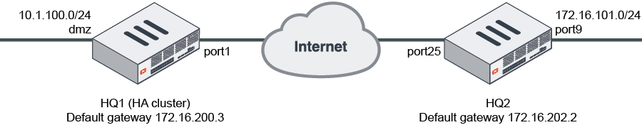

This is a sample configuration of site-to-site IPsec VPN in an HA environment.
For this example, set up HA as described in the HA topics. When setting up HA, enable the following options to ensure IPsec VPN traffic is not interrupted during an HA failover:
session-pickupunder HA settings.ha-sync-esp-seqnounder IPsec phase1-interface settings.
You can configure IPsec VPN in an HA environment using the GUI or CLI.
In this example, the VPN name for HQ1 is "to_HQ2", and the VPN name for HQ2 is "to_HQ1".

- Configure HA. In this example, two FortiGates work in active-passive mode. The HA heartbeat interfaces are WAN1 and WAN2:
config system ha
set group-name "FGT-HA"
set mode a-p
set password sample
set hbdev "wan1" 50 "wan2" 50
set session-pickup enable
set priority 200
set override-wait-time 10
- Configure the WAN interface and default route. The WAN interface is the interface connected to the ISP. It can work in static mode (as shown in this example), DHCP, or PPPoE mode. The IPsec tunnel is established over the WAN interface.
