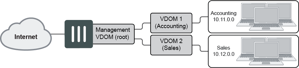

This example shows how to configure a FortiGate unit to use inter-VDOM routing.
Two departments of a company, Accounting and Sales, are connected to one FortiGate. The company uses a single ISP to connect to the Internet.

Configure the VDOM links
To complete the connection between each VDOM and the management VDOM, add the two VDOM links. One pair is the Accounting – management link and the other is the Sales – management link.
When configuring inter-VDOM links, you do not have to assign IP addresses to the links unless you are using advanced features such as dynamic routing that require them. Not assigning IP addresses results in faster configuration and more available IP addresses on your networks.
