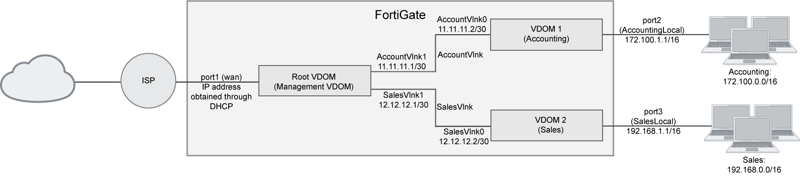

This example shows how to configure a FortiGate unit to use inter-VDOM routing to route outgoing traffic from individual VDOMs to a root VDOM with Internet access. See Inter-VDOM routing for more information.
Two departments of a company, Accounting and Sales, are connected to one FortiGate. The company uses a single ISP to connect to the Internet. This is an example of the Internet access configuration. See Topologies for details.
This example assumes that the interfaces of the FortiGate have already been configured with the IP addresses depicted in the preceding diagram.

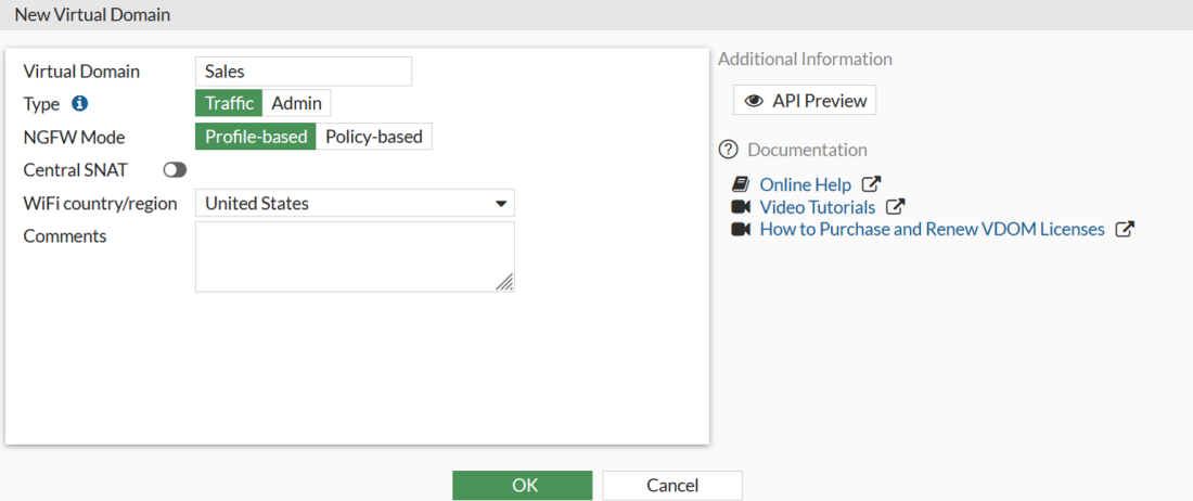

To create the Sales and Accounting VDOMs in the GUI:
In the Global VDOM, go to System > VDOM.
Click Create New.
In the Virtual Domain field, enter Sales.
If required, set the NGFW Mode. If the NGFW Mode is Profile-based, Central SNAT can be enabled.
Click OK to create the VDOM.
Repeat the above steps for Accounting.

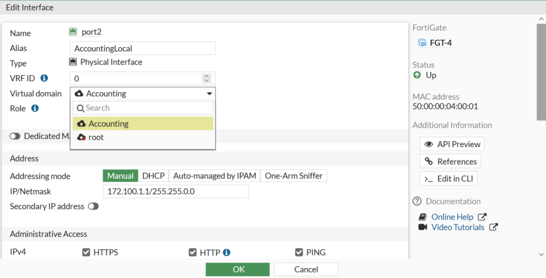

In the Global VDOM, go to Network > Interfaces.
Select port2 and click Edit.
From the Virtual domain list, select Accounting.
Click OK.
Repeat the preceding steps to assign port3 to the Sales VDOM.
Repeat the preceding steps to assign port1 to the root VDOM.
