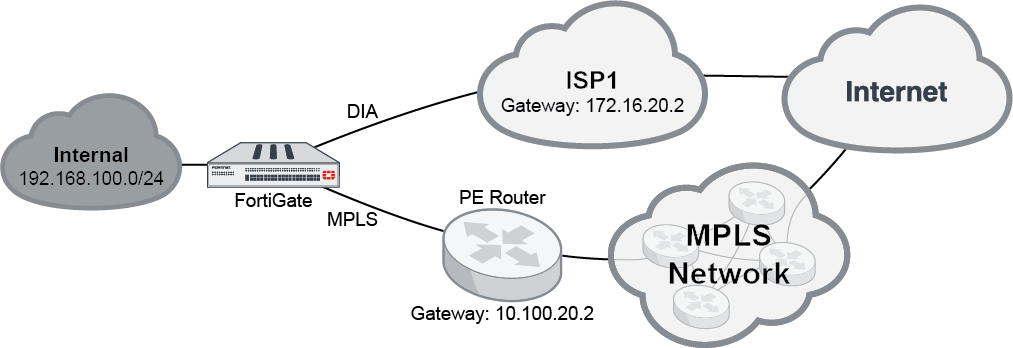

This example covers a typical usage scenario where the SD-WAN has two members: MPLS and DIA. DIA is primarily used for direct internet access to internet applications, such as Office365, Google applications, Amazon, and Dropbox. MPLS is primarily used for SIP, and works as a backup when DIA is not working.
This example configures all SIP traffic to use MPLS while all other traffic uses DIA. If DIA is not working, the traffic will use MPLS.

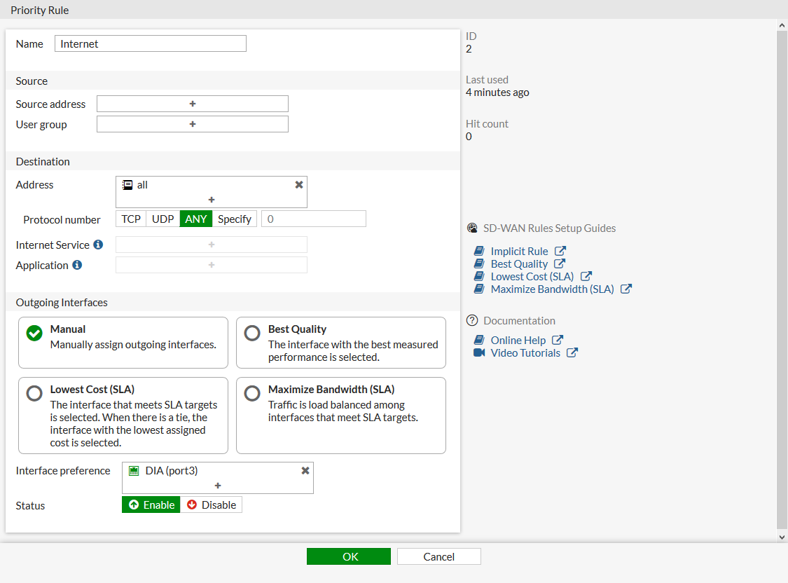

- Click Create New to create another rule.
- Enter a name for the rule, such as Internet.
- Click the Address field and select all from the panel.
- Under Outgoing Interfaces, select Manual.
- For Interface preference, select DIA.
- Click OK.

All SIP traffic uses MPLS. All other traffic goes to DIA. If DIA is broken, the traffic uses MPLS. If you use VPN instead of MPLS to run SIP traffic, you must configure a VPN interface, for example vpn1, and then replace member 1 from MPLS to vpn1 for SD-WAN member.
