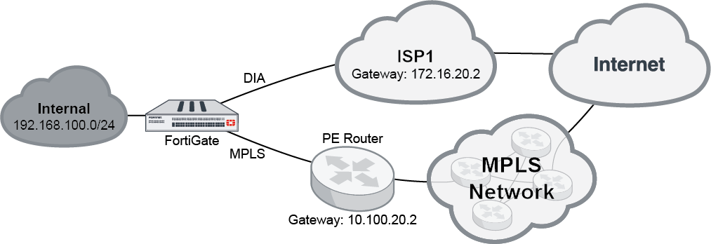

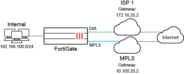

This example covers a typical usage scenario where the SD-WAN has two members: MPLS and DIA. DIA is primarily used for direct internet access to internet applications, such as Office365, Google applications, Amazon, and Dropbox. MPLS is primarily used for SIP, and works as a backup when DIA is not working.
This example configures all SIP traffic to use MPLS while all other traffic uses DIA. If DIA is not working, the traffic will use MPLS.
