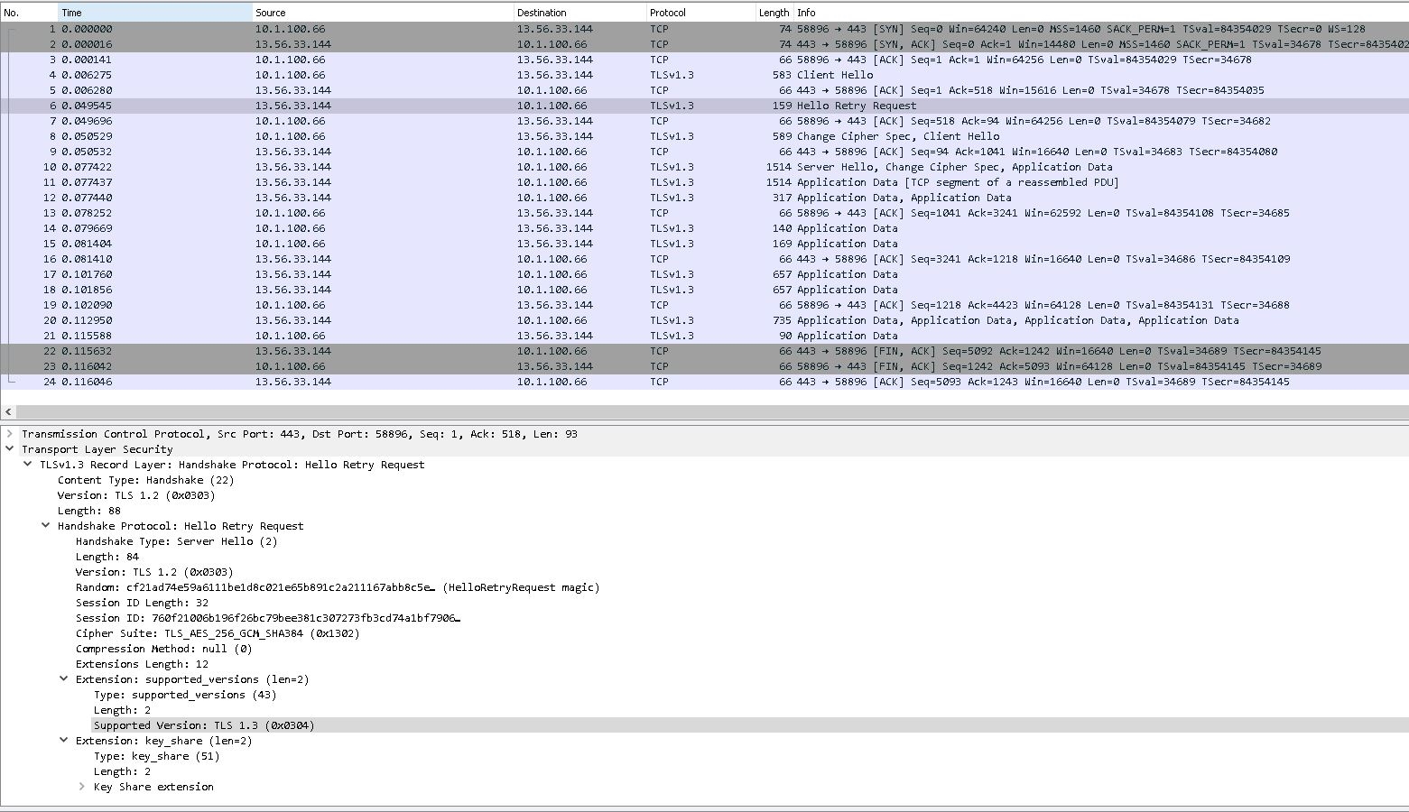

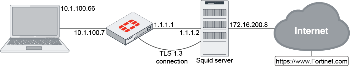

Using TLS 1.3 with web proxy forward servers
A FortiGate can handle TLS 1.3 traffic in both deep and certificate inspection modes.
Example
The following example demonstrates that the Squid server and the FortiGate can handle TLS 1.3 traffic.
The following output from the Squid server demonstrates that the FortiGate supports TLS 1.3 traffic and forwards the hello retry request back to the client PC. The client PC then sends the client hello again, and the connection is successfully established.
