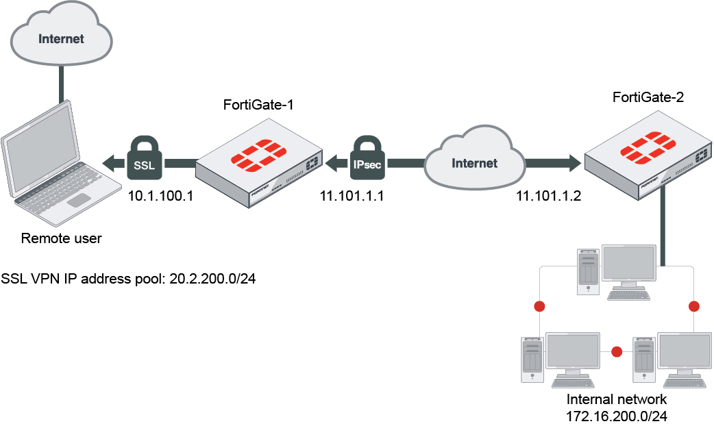

This is a sample configuration of site-to-site IPsec VPN that allows access to the remote endpoint via SSL VPN.
This example uses a pre-existing user group, a tunnel mode SSL VPN with split tunneling, and a route-based IPsec VPN between two FortiGates. All sessions must start from the SSL VPN interface.
If you want sessions to start from the FGT_2 subnet, you need more policies. Also, if the remote subnet is beyond FGT_2 (if there are multiple hops), you need to include the SSL VPN subnet in those routers as well.
Sample topology

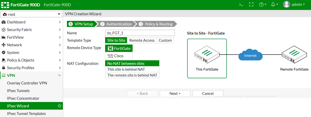

To configure the site-to-site IPsec VPN on FGT_1:
- Go to VPN > IPsec Wizard.
- In the VPN Setup pane:
- Specify the VPN connection Name as to_FGT_2.
- Select Site to Site.
- Click Next.

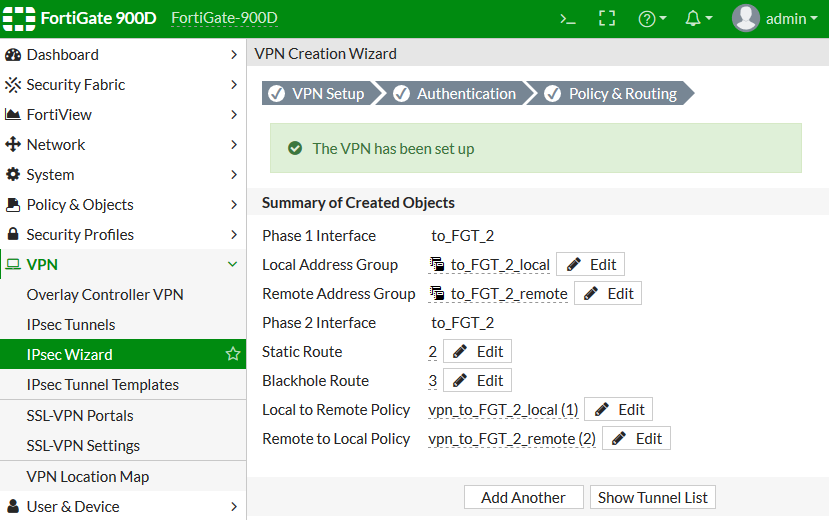

- In the Policy & Routing pane:
- Set the Local Interface to the internal interface.
- Set the Local Subnets to include the internal and SSL VPN subnets for FGT_1.
- Set Remote Subnets to include the internal subnet for FGT_2.
- Click Create.
A confirmation screen shows a summary of the configuration including the firewall address groups for both the local and remote subnets, static routes, and security policies.

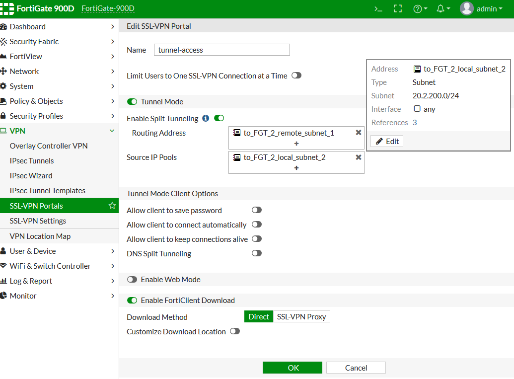

To configure SSL VPN portal:
- Go to VPN > SSL-VPN Portals.
- Select tunnel-access and click Edit.
- Turn on Enable Split Tunneling so that only traffic intended for the local or remote networks flow through FGT_1 and follows corporate security profiles.
- For Routing Address, add the local and remote IPsec VPN subnets created by the IPsec Wizard.
- For Source IP Pools, add the SSL VPN subnet range created by the IPsec Wizard.
- Click OK.

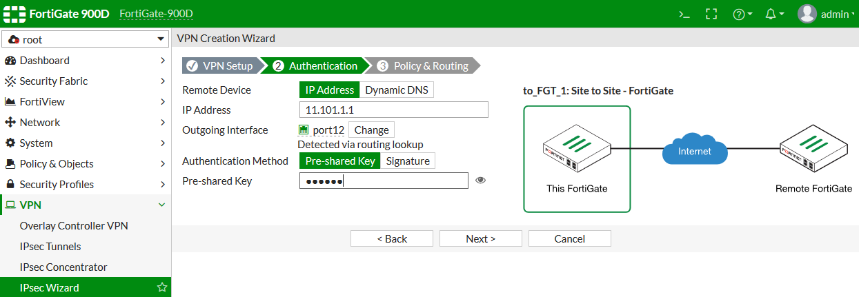

To configure the site-to-site IPsec VPN on FGT_2:
- Specify the VPN connection Name as to FGT_1.
- Click Next.
- In the Authentication pane:
- Enter the IP Address to the Internet-facing interface.
- For Authentication Method, click Pre-shared Key and enter the Pre-shared Key of the FGT_1.
- Click Next.

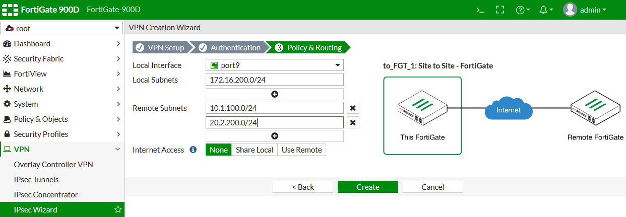

- Set the Local Subnets to include the internal and SSL VPN subnets for FGT_2.
- Set Remote Subnets to include the internal subnet for FGT_1.
- Click Create.

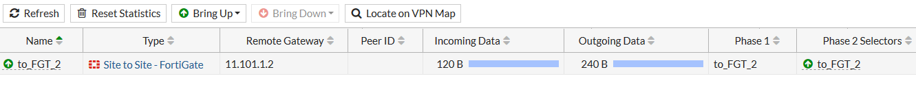

To check the results:
- Go to Monitor > IPsec Monitor.
- Select the tunnel and click Bring Up.
- Verify that the Status changes to Up.

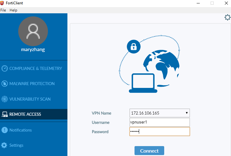

- Configure the SSL VPN connection on the user's FortiClient and connect to the tunnel.
- On the user's computer, use CLI to send a ping though the tunnel to the remote endpoint to confirm access.

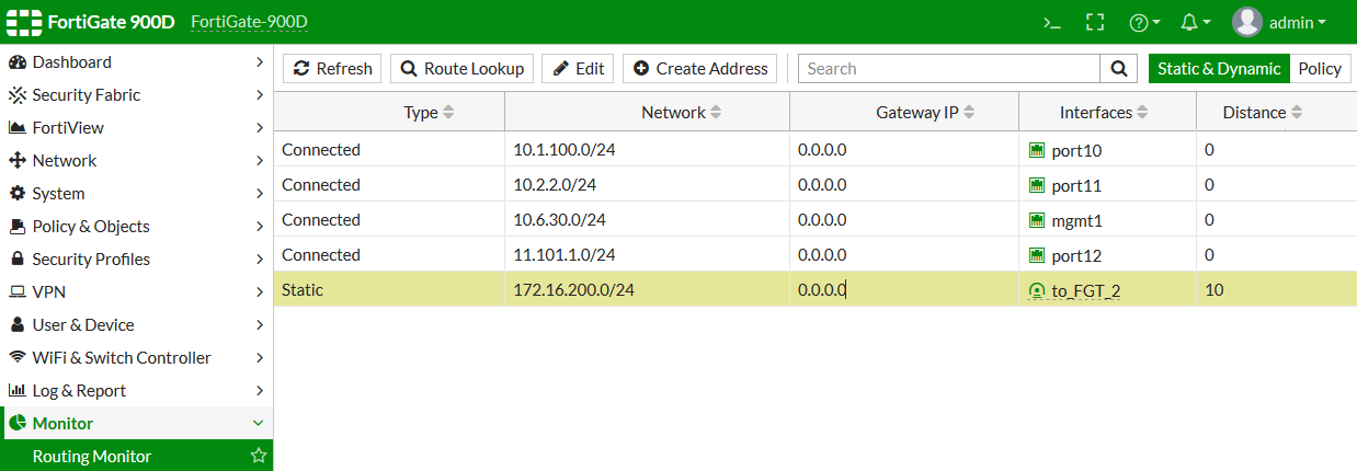

- Go to Monitor > Routing Monitor and verify that the routes for the IPsec and SSL VPNs are added.

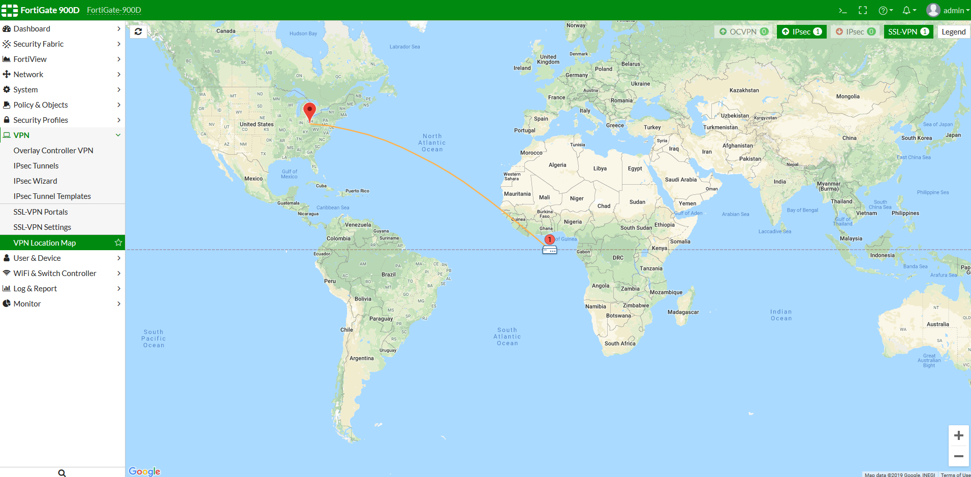

- Go to VPN > VPN Location Map and view VPN connection activity.
