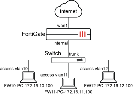

Physical topology:

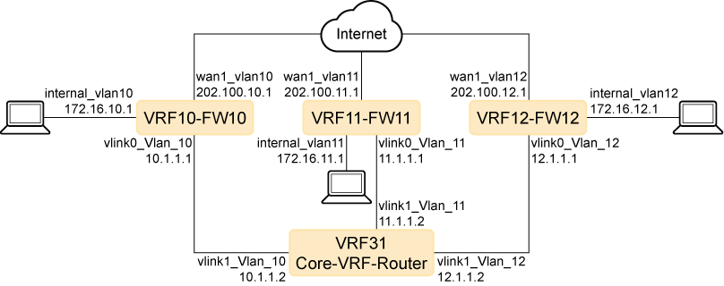

Logical topology:
In this example, a specific route is leaked from each of the VRFs to each of the other VRFs. VLAN subinterfaces are created based on VDOM links to connect each VRF to the core VRF router.
NPU inter-VDOM links are used to accelerate traffic between VRFs. The setup could be configured by creating non-NPU VDOM links, but this is not recommended as these links are not offloaded to the NPU.

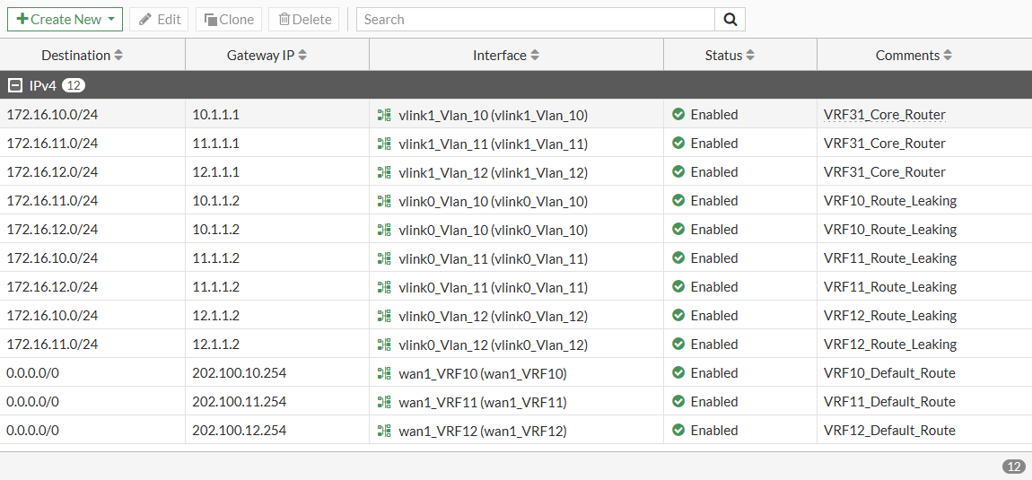

  7. Configure static routing and route leaking between each VRF and Core-VRF-Router:
    config router static
            set dst 172.16.10.0 255.255.255.0
            set gateway 10.1.1.1
            set device "vlink1_Vlan_10"
            set comment "VRF31_Core_Router"
            set dst 172.16.11.0 255.255.255.0
            set gateway 11.1.1.1
            set device "vlink1_Vlan_11"
        edit 3
            set dst 172.16.12.0 255.255.255.0
            set gateway 12.1.1.1
            set device "vlink1_Vlan_12"
        edit 4
            set gateway 10.1.1.2
            set device "vlink0_Vlan_10"
            set comment "VRF10_Route_Leaking"
        edit 5
        edit 6
            set gateway 11.1.1.2
            set device "vlink0_Vlan_11"
            set comment "VRF11_Route_Leaking"
        edit 7
        edit 8
            set gateway 12.1.1.2
            set device "vlink0_Vlan_12"
            set comment "VRF12_Route_Leaking"
        edit 9
        edit 10
            set gateway 202.100.10.254
            set device "wan1_VRF10"
            set comment "VRF10_Default_Route"
        edit 11
            set gateway 202.100.11.254
            set device "wan1_VRF11"
            set comment "VRF11_Default_Route"
        edit 12
            set gateway 202.100.12.254
            set device "wan1_VRF12"
            set comment "VRF12_Default_Route"
    In the GUI, go to Network > Static Routes to view the static routes:

In this example, routing leaking between three VRFs in a star topology is configured. This allows the solution to be scaled to more VRFs without building full mesh, one-to-one connections between each pair of VRFs. VLAN subinterfaces are created on VDOM links to connect each VRF to the central VRF, allowing routes to be leaked from a VRF to the central VRF, and then to the other VRFs. Static routes are used for route leaking in this example.
For instructions on creating route leaking between two VRFs, see Route leaking between VRFs with BGP.
Physical topology:
Logical topology:
        edit 3
        edit 4
        edit 5
        edit 6
        edit 7
        edit 8
        edit 9
        edit 10
        edit 11
        edit 12

    Routing table for VRF=12
    S*      0.0.0.0/0 [10/0] via 202.100.12.254, wan1_VRF12
    C       12.1.1.0/30 is directly connected, vlink0_Vlan_12
    S       172.16.10.0/24 [10/0] via 12.1.1.2, vlink0_Vlan_12
    S       172.16.11.0/24 [10/0] via 12.1.1.2, vlink0_Vlan_12
    C       172.16.12.0/24 is directly connected, Internal_VRF12
    C       202.100.12.0/24 is directly connected, wan1_VRF12
    Routing table for VRF=31
    C       10.1.1.0/30 is directly connected, vlink1_Vlan_10
    C       11.1.1.0/30 is directly connected, vlink1_Vlan_11
    C       12.1.1.0/30 is directly connected, vlink1_Vlan_12
    S       172.16.10.0/24 [10/0] via 10.1.1.1, vlink1_Vlan_10
    S       172.16.11.0/24 [10/0] via 11.1.1.1, vlink1_Vlan_11
    S       172.16.12.0/24 [10/0] via 12.1.1.1, vlink1_Vlan_12
