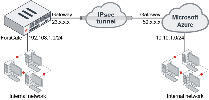

This example shows how to configure a site-to-site IPsec VPN tunnel to Microsoft Azure. It shows how to configure a tunnel between each site, avoiding overlapping subnets, so that a secure tunnel can be established.

Sample topology

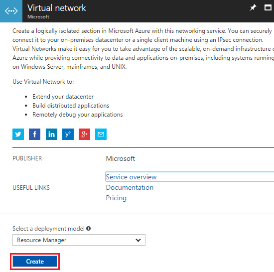

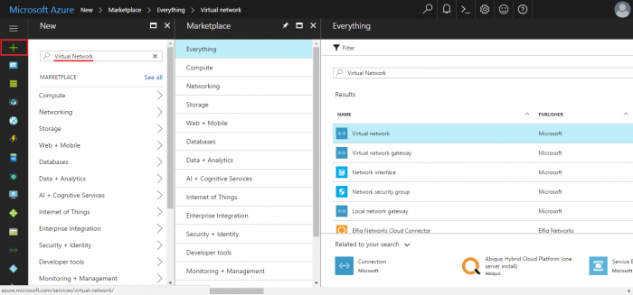

- Log in to Azure and click New.
- In Search the Marketplace, type Virtual network.
- Click Virtual network to open the Virtual network pane.
- At the bottom of the Virtual network pane, click the Select a deployment model dropdown list and select Resource Manager.
- Click Create.

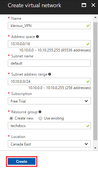

- On the Create virtual network pane, enter you virtual network settings, and click Create.

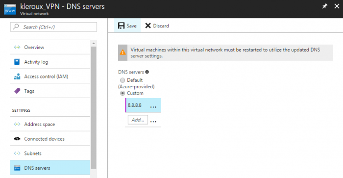

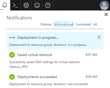

To specify the Azure DNS server:
- Open the virtual network you just created.
- Click DNS servers to open the DNS servers pane.
- Enter the IP address of the DNS server and click Save.

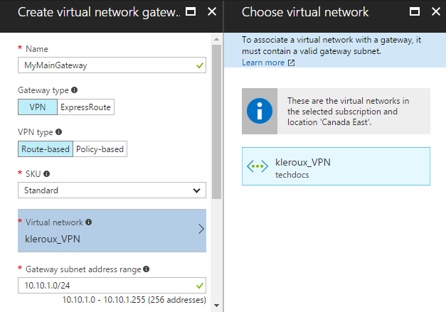

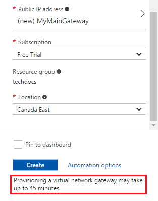

To configure the Azure virtual network gateway:

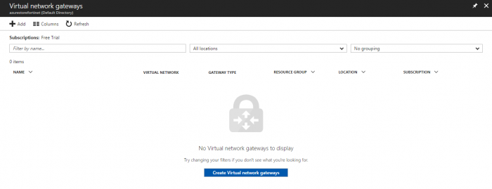

- In the portal dashboard, go to New.
- Search for Virtual Network Gateway and click it to open the Virtual network gateway pane.
- Click Create Virtual network gateways and enter the settings for your virtual network gateway.
- If needed, create a Public IP address.
- Click Create.
Creating the virtual network gateway might take some time. When the provisioning is done, you'll receive a notification.

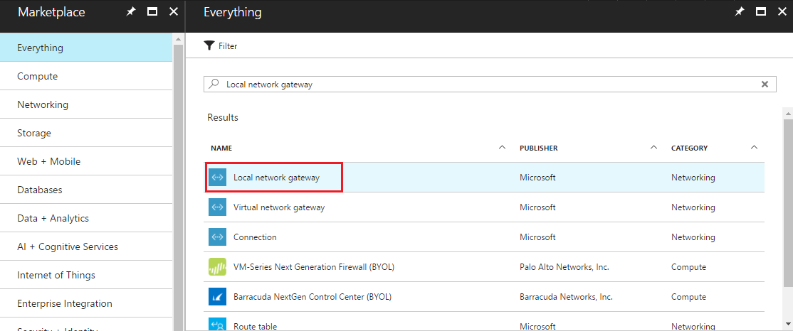

To configure the Azure local network gateway:

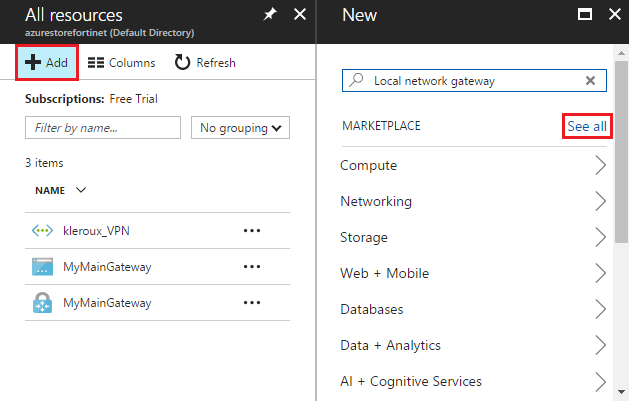

- In the portal dashboard, click All resources.
- Click Add and then click See all.

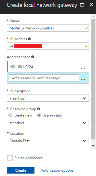

- In the Everything pane, search for Local network gateway and then click Create local network gateway.
- For the IP address, enter the local network gateway IP address, that is, the FortiGate's external IP address.
- Set the remaining values for your local network gateway and click Create.

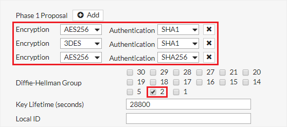

- Configure the Phase 1 Proposal settings.
- Set the Encryption and Authentication combination to the three supported encryption algorithm combinations accepted by Azure.
- AES256 and SHA1
- 3DES and SHA1
- AES256 and SHA256
- For Diffie-Hellman Groups, select 2.
- Set Key Lifetime (seconds) to 28800.

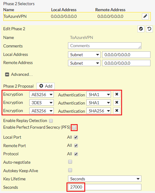

- In Phase 2 Selectors, expand the Advanced section to configure the Phase 2 Proposal settings.
- Set the Encryption and Authentication combinations.
- AES256 and SHA1
- 3DES and SHA1
- AES256 and SHA256
- Uncheck Enable Perfect Forward Secrecy (PFS).
- Set Key Lifetime (seconds) to 27000.
- Click OK.

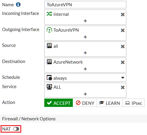

To create the FortiGate firewall policies:

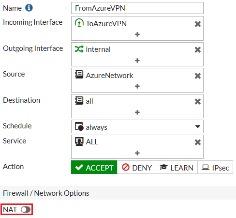

- In the FortiGate, go to Policy & Objects > Firewall Policy.
- Create a policy for the site-to-site connection that allows outgoing traffic.
- Set the Source address and Destination address using the firewall objects you just created.
- Disable NAT.
- Create another policy that allows incoming traffic.
- For this policy, reverse the Source address and Destination address.

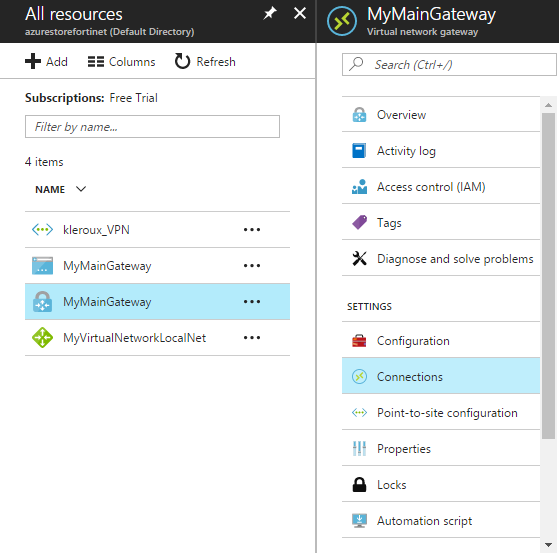

- In the Azure portal, locate and select your virtual network gateway.
- In the Settings pane, click Connections and then click Add.

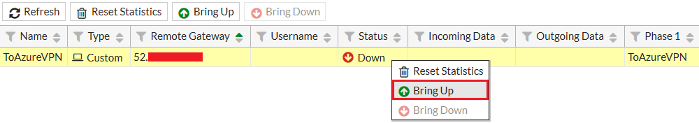

To check the results:
- In the FortiGate, go to Monitor > IPsec Monitor.
- Check that the tunnel is up.
- If the tunnel is down, right-click the tunnel and select Bring Up.

- In the Azure portal dashboard, click All resources and locate your virtual network gateway.
- In your virtual network gateway pane, click Connections to see the status of each connection.
