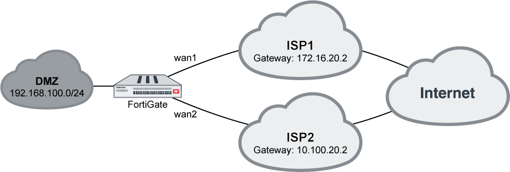

Sample topology
Sample configuration
This example shows a typical customer usage where the customer's SD-WAN has two member: wan1 and wan2 and each is 10Mb/s.
An overview of the procedures to configure SD-WAN traffic shaping and QoS with SD-WAN includes:
  1. Give HTTP/HTTPS traffic high priority and give FTP low priority so that if there are conflicts, FortiGate will forward HTTP/HTTPS traffic first.
  2. Even though FTP has low priority, configure FortiGate to give it a 1Mb/s guaranteed bandwidth on each SD-WAN member so that if there is no FTP traffic, other traffic can use all the bandwidth. If there is heavy FTP traffic, it can still be guaranteed a 1Mb/s bandwidth.
  3. Traffic going to specific destinations such as a VOIP server uses wan1 to forward, and SD-WAN forwards with an Expedited Forwarding (EF) DSCP tag 101110.

Sample topology
