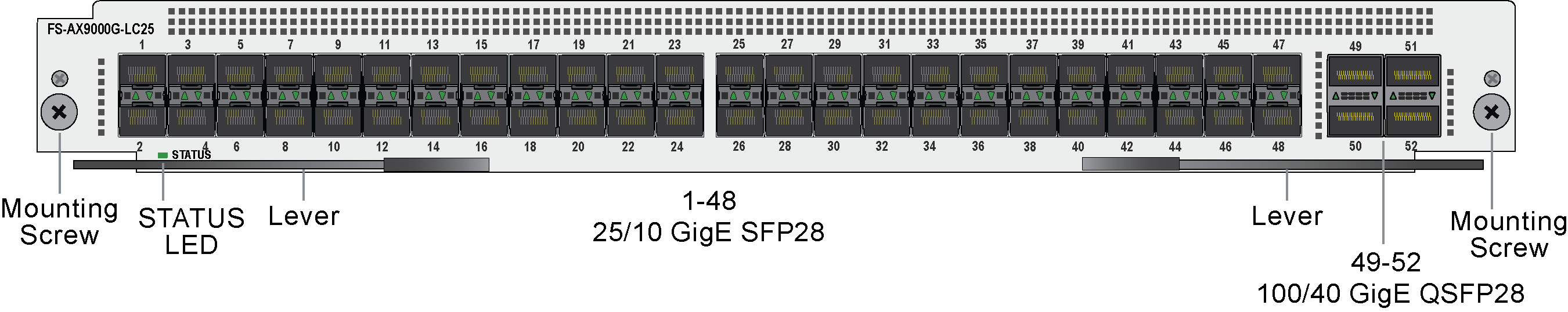

The FS-AX9000G-LC25 features the following front panel interfaces:
  • Forty-eight 25/10 GigE SFP28 (1-48, 1000BASE-X is not supported on ports 1-48)
  • Four 100/40 GigE QSFP28 (49-52)
FS-AX9000G-LC25 front panel
