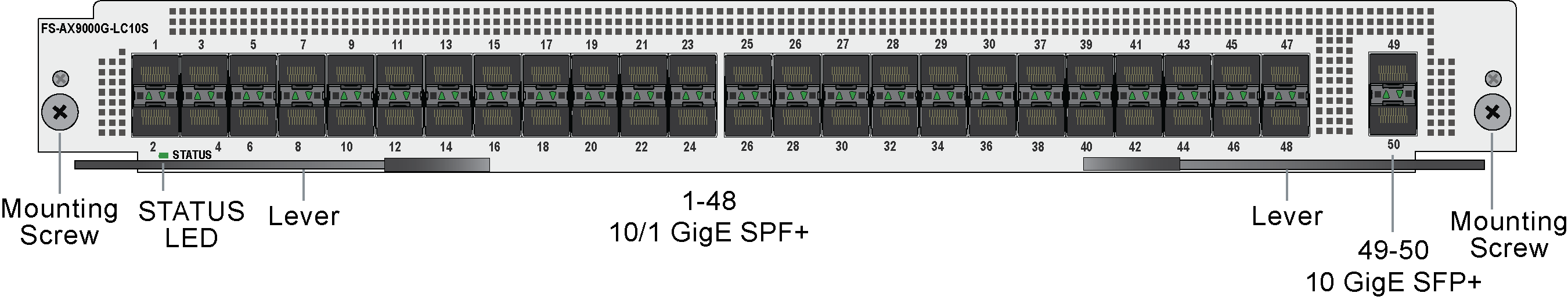

The FS-AX9000G-LC10S features the following front panel interfaces:
  • Forty-eight 10/1 GigE SPF+ (1-48)
  • Two 10 GigE SFP+ (49 and 50, 1000BASE-X is not supported on ports 49 and 50)
FS-AX9000G-LC10S front panel

Front panel LEDs
LED
State
STATUS
Off
The FS-AX9000G-LC10S is powered off.
Green
The FS-AX9000G-LC10S is powered on and operating normally.
Flashing Green
The FS-AX9000G-LC10S is starting up or has been stopped by inputting the inactivate command.
Red
Line card fault detected.
LINK
Off
Network cable is not connected or link failure or operation is stopped.
Green
Link established.
Flashing Green
Packets are being sent or received.
Orange
Port fault detected.

FS-AX9000G-LC10S line card

Front panel LEDs
LED
State
STATUS
Off
Green
Flashing Green
Red
LINK
Off
Green
Link established.
Flashing Green
Orange
