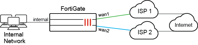

This example shows how to convert a standalone FortiGate SD-WAN solution to a FGCP HA cluster with full-mesh WAN set up. This configuration allows you to load balance your internet traffic between multiple ISP links. It also provides redundancy for your internet connection if your primary ISP in unavailable, or if one of the FortiGates in the HA cluster fails.
This example assumes that a standalone FortiGate has already been configured for SD-WAN by following the SD-WAN quick start.

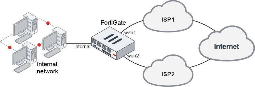

Standalone FortiGate:

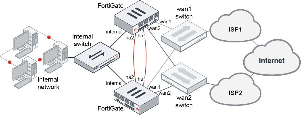

FGCP HA cluster:

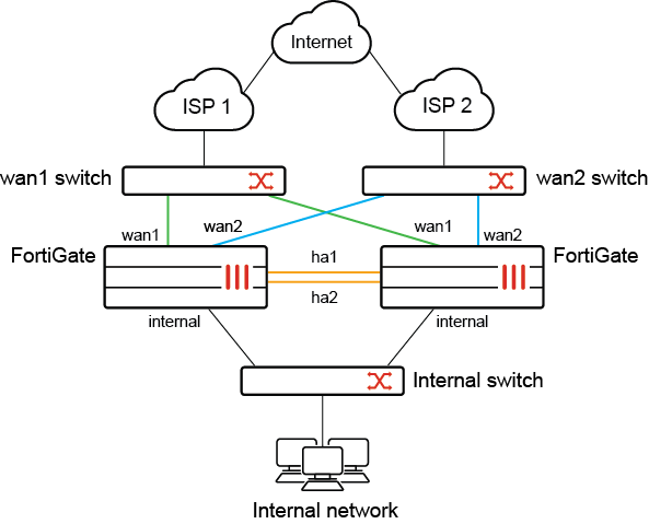

The following devices are required to convert the topology to HA:
- A second FortiGate that is the same model running the same firmware version.
- Two switches for connecting each FortiGate's WAN interface to the corresponding ISP modem.

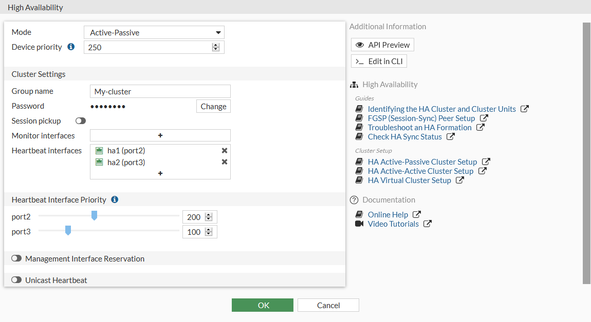

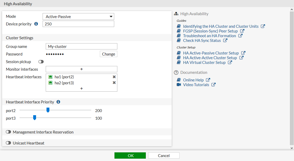

To configure the standalone FortiGate for HA in the GUI:
- Go to System > Settings and change the Host name so that the FortiGate can be easily identified as the primary unit.
- Go to System > HA and configure the following options:
Mode
Active-Passive
Device priority
250
Group name
My-cluster
Password
<password>
Heartbeat interfaces
ha1 and ha2
Heartbeat Interface Priority
port2 (ha1): 200
port3 (ha2): 100
Override and the group ID can only be configured from the CLI.
- Click OK.
Connectivity with the FortiGate will temporarily be lost.

Connecting the heartbeat interfaces between the FortiGates
To connect and check the heartbeat interfaces:
- Connect the heartbeat interfaces ha1 and ha2 between the primary and secondary FortiGate.

Connecting other traffic interfaces
After the device configurations are synchronized, you can connect the rest of the traffic interfaces. Making these connections will disrupt traffic as cables are disconnected and reconnected.
Switches must be used between the cluster and the ISPs, and between the cluster and the internal network, as shown in the topology diagram.

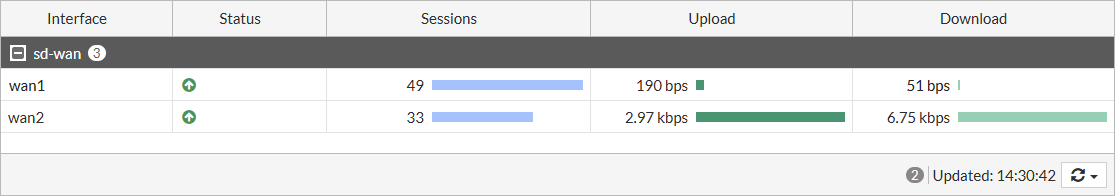

- Browse the internet on a computer in the internal network.
- Go to Network > SD-WAN and select the SD-WAN Zones tab to see the bandwidth, volume, and sessions for traffic on the SD-WAN interfaces. See Results for details.
- Go to Dashboard > Network, and expand the SD-WAN widget to see information about each interface, such as the number of sessions and the bit rate.

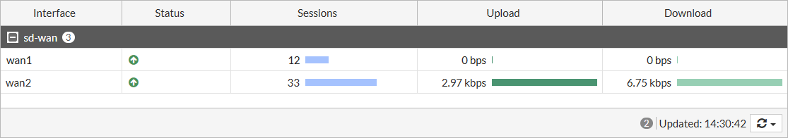

After disconnecting, verify that users still have internet access
- Go to Dashboard > Network, and expand the SD-WAN widget. The Upload and Download columns for wan1 show that traffic is not going through that interface.

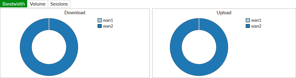

- Go to Network > SD-WAN and select the SD-WAN Zones tab. The Bandwidth, Volume, and Sessions tabs show that traffic is entirely diverted to wan2.
Users on the network should not notice the wan1 failure. If you are using the wan1 gateway IP address to connect to the administrator dashboard, it will appear as though you are still connecting through wan1.
