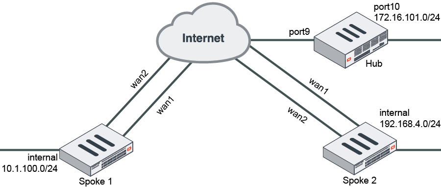

This is a sample configuration of ADVPN with BGP as the routing protocol. The following options must be enabled for this configuration:

To configure ADVPN with BGP as the routing protocol using the CLI:
Configure hub FortiGate WAN interface, internal interface, and a static route:
config system interface edit "port9" set alias "WAN" set ip 22.1.1.1 255.255.255.0 next edit "port10" set alias "Internal" set ip 172.16.101.1 255.255.255.0 next end config router static edit 1 set gateway 22.1.1.2 set device "port9" next end -

Configure the spoke FortiGates:
Configure the spoke FortiGates' WAN, internal interfaces, and static routes:
Configure Spoke1:
config system interface edit "wan1" set alias "primary_WAN" set ip 15.1.1.2 255.255.255.0 next edit "wan2" set alias "secondary_WAN" set ip 12.1.1.2 255.255.255.0 next edit "internal" set ip 10.1.100.1 255.255.255.0 next end config router static edit 1 set gateway 12.1.1.1 set device "wan2" set distance 15 next edit 2 set gateway 15.1.1.1 set device "wan1" next end -
Configure the Spoke2:
config system interface edit "wan1" set alias "primary_WAN" set ip 13.1.1.2 255.255.255.0 next edit "wan2" set alias "secondary_WAN" set ip 17.1.1.2 255.255.255.0 next edit "internal" set ip 192.168.4.1 255.255.255.0 next end config router static edit 1 set gateway 17.1.1.1 set device "wan2" set distance 15 next edit 2 set gateway 13.1.1.1 set device "wan1" next end
