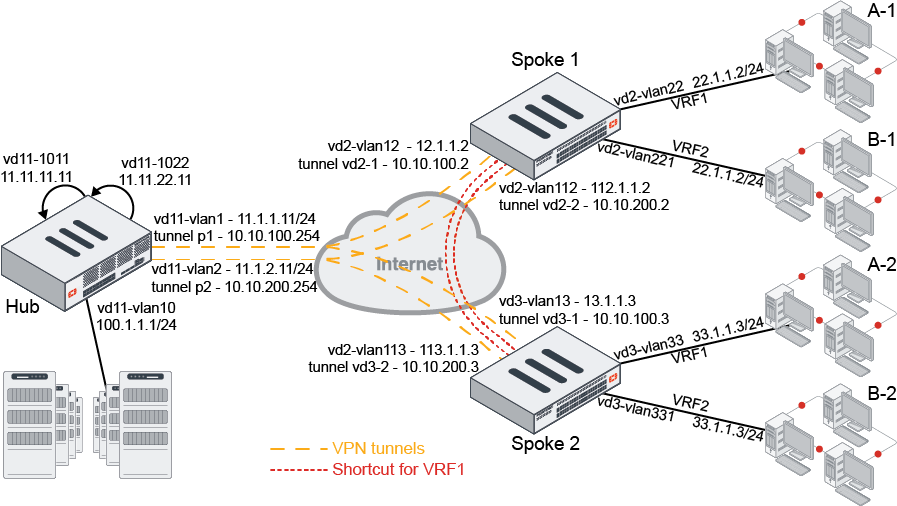

In this example, multiple companies (or departments of a company) share the same hub and spoke VPN infrastructure. Company A and company B each have two branches in two different locations. The goal is for company A’s branches (A-1 and A-2) to be able to communicate only with each other over VPN but not with company B’s branches. Likewise, company B’s branches (B-1 and B-2) can only communicate with each other over VPN but not with company A’s. This is accomplished by placing each branch VLAN into their respective VRFs (VRF1 and VRF2), and encapsulating the VRF information within the VPN tunnel. The hub forms BGP peering with its neighbors, spoke 1 and spoke 2, over each IPsec overlay. The hub’s BGP route reflector reflects the routes to the corresponding VRFs, allowing each spoke to form ADVPN shortcuts with the other spoke for each VRF.
However, in this scenario, we want A-1 and A-2 to use an ADVPN shortcut, but we do not want B-1 and B-2 to use ADVPN. A route map is configured on the hub to match the desired extended community route target number where only this route target is permitted, and others are denied. This allows the hub’s BGP route reflector to only reflect routes associated with VRF1, allowing the spokes to form an ADVPN shortcut for VRF1. Routes associated with VRF2 are not reflected, and each spoke must route traffic through the hub to reach VRF2 on the other spoke.
