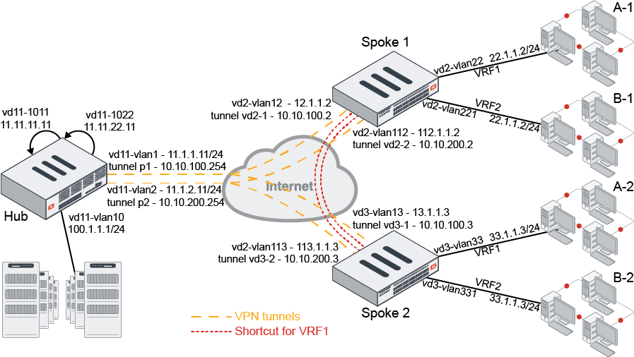

Example
In this example, multiple companies (or departments of a company) share the same hub and spoke VPN infrastructure. Company A and company B each have two branches in two different locations. The goal is for company A’s branches (A-1 and A-2) to be able to communicate only with each other over VPN but not with company B’s branches. Likewise, company B’s branches (B-1 and B-2) can only communicate with each other over VPN but not with company A’s. This is accomplished by placing each branch VLAN into their respective VRFs (VRF1 and VRF2), and encapsulating the VRF information within the VPN tunnel. The hub forms BGP peering with its neighbors, spoke 1 and spoke 2, over each IPsec overlay. The hub’s BGP route reflector reflects the routes to the corresponding VRFs, allowing each spoke to form ADVPN shortcuts with the other spoke for each VRF.
However, in this scenario, we want A-1 and A-2 to use an ADVPN shortcut, but we do not want B-1 and B-2 to use ADVPN. A route map is configured on the hub to match the desired extended community route target number where only this route target is permitted, and others are denied. This allows the hub’s BGP route reflector to only reflect routes associated with VRF1, allowing the spokes to form an ADVPN shortcut for VRF1. Routes associated with VRF2 are not reflected, and each spoke must route traffic through the hub to reach VRF2 on the other spoke.
Configure the topology by following the instructions of Example 1 in SD-WAN segmentation over a single overlay. Note that when checking the spoke 1 routes in example 1, there is a VRF2 route:

The following procedure applies a route map on the hub’s BGP configurations to limit route reflection to only routes matching the external community target of 1:1. This external community target corresponds to BGP paths for VRF1 learned from spoke 1 and spoke 2. The external community target of 2:1 corresponds to BGP paths for VRF2. By not explicitly permitting this target (2:1) in the community list and denying everything other than the permitted target (1:1) in the route map, the VRF2 BGP paths are essentially omitted from being reflected to the spokes.
To configure BGP filtering for an extended community route target on the hub:
  1. Identify the external community target of VRF1 to be permitted:

    B*      0.0.0.0/0 [200/0] via 10.10.100.254 (recursive via vd2-1 tunnel 11.1.1.11), 03:47:50, [1/0]
                      [200/0] via 10.10.200.254 (recursive via vd2-2 tunnel 11.1.2.11), 03:47:50, [1/0]
    B       1.1.1.1/32 [200/0] via 11.1.1.1 [2] (recursive via 12.1.1.1, vd2-vlan12), 03:47:50, [1/0]
    B       1.222.222.222/32 [200/0] via 11.1.1.1 [2] (recursive via 12.1.1.1, vd2-vlan12), 03:47:50, [1/0]
    B       11.11.11.11/32 [200/0] via 10.10.100.254 (recursive via vd2-1 tunnel 11.1.1.11), 03:47:50, [1/0]
    B       33.1.1.0/24 [200/0] via 10.10.100.254 [2] (recursive via vd2-1 tunnel 11.1.1.11), 03:47:21, [1/0]
                        [200/0] via 10.10.200.254 [2] (recursive via vd2-2 tunnel 11.1.2.11), 03:47:21, [1/0]
    Routing table for VRF=1
    B V     11.11.22.11/32 [200/0] via 10.10.100.254 (recursive via vd2-1 tunnel 11.1.1.11), 03:47:50, [1/0]
    B V     33.1.1.0/24 [200/0] via 10.10.100.3 [2] (recursive via vd2-1 tunnel 11.1.1.11), 03:47:21, [1/0]
                        [200/0] via 10.10.200.3 [2] (recursive via vd2-2 tunnel 11.1.2.11), 03:47:21, [1/0]
    B V     100.1.1.0/24 [200/0] via 10.10.100.254 (recursive via vd2-1 tunnel 11.1.1.11), 03:47:50, [1/0]
