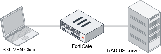

In this example, the user wants to present one FortiGate VDOM with different NAS-IPs to a single RADIUS server based on specific rules.

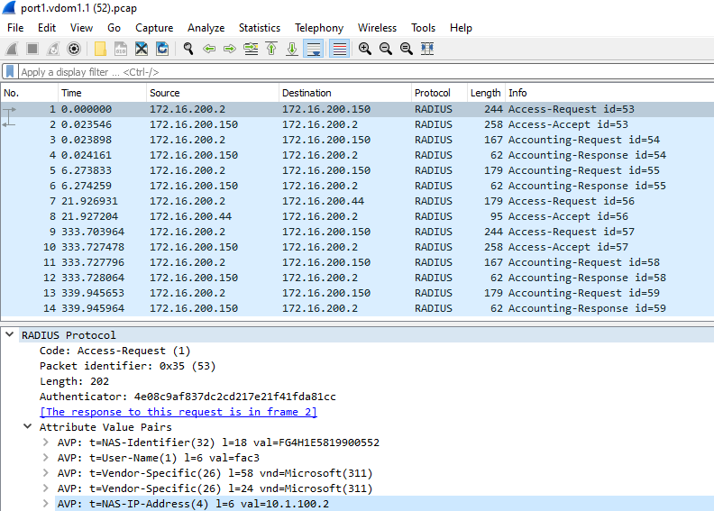

config vpn ssl web realm edit "realm1" set login-page '.......' set radius-server "fac150" set nas-ip 10.1.100.2 next end - Configure SSL-VPN with an authentication rule that includes the user group and the realm:
config vpn ssl settings ... config authentication-rule edit 1 set groupd "radgrp" set portal "testportal1" set realm "realm1" next end end - Create a firewall policy:
config firewall policy edit 1 set name "sslvpn1" ... set srcintf "ssl.vdom1" set groups "radgrp" next endBecause the RADIUS server and NAS-IP are specified in realm1, its NAS-IP is used for authentication.
