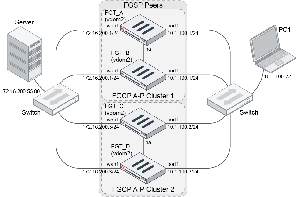

In this example, there is a simplified configuration where there is no router or load balancer performing balancing between the FGSP peers, but it demonstrates the following:
- When sessions pass through FGCP A-P Cluster 1, all sessions are synchronized between the FGT_A and FGT_B regardless of the session synchronization filter.
- Session synchronization between the FGSP peers (FGCP A-P Cluster 1 and 2) only occurs for the service specified in the filter, which is HTTP/80.

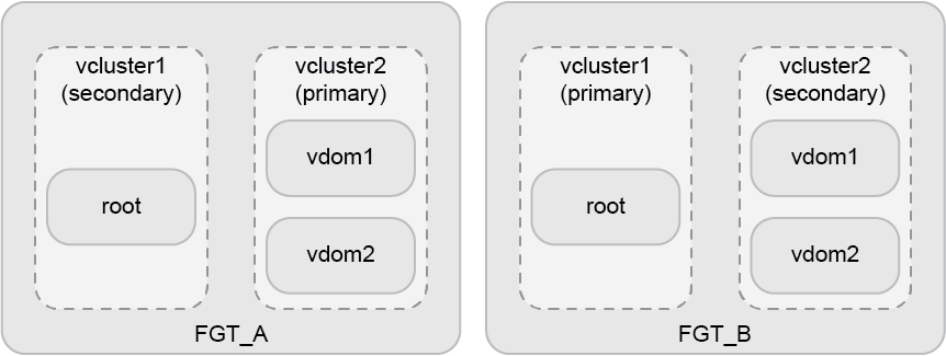

- The preceding behavior is applicable when virtual clustering is configured. This example focuses on vdom2, which belongs to vcluster2. FGT_A is the primary for vcluster2.
Each FGSP A-P cluster is connected on ha as the FGCP cluster heartbeat device. The FGSP peers are connected on mgmt over 10.1.1.1-2/24.
Virtual clustering between FGT_A and FGT_B:

To verify the configuration:
Verify the FGSP peer information on Cluster 1:
FGT_A (global) # diagnose sys ha fgsp-zone Local standalone-member-id: 1 FGSP peer_num = 1 peer[1]: standalone-member-id=2, IP=10.1.1.2, vd=vdom2, prio=1 -
Verify the FGSP peer information on Cluster 2:
FGT_C (global) # diagnose sys ha fgsp-zone Local standalone-member-id: 1 FGSP peer_num = 1 peer[1]: standalone-member-id=1, IP=10.1.1.1, vd=vdom2, prio=1 -
Initiate two sessions, HTTP and SSH.
Verify that the HTTP session is synchronized from Cluster 1 to Cluster 2.
Verify the session list of vdom2 on FGT_A:
FGT_A (vdom2) # diagnose sys session list session info: proto=6 proto_state=01 duration=693 expire=3593 timeout=3600 flags=00000000 socktype=0 sockport=0 av_idx=0 use=4 origin-shaper= reply-shaper= per_ip_shaper= class_id=0 ha_id=1:0 policy_dir=0 tunnel=/ vlan_cos=0/255 state=log may_dirty npu synced f00 statistic(bytes/packets/allow_err): org=87531/1678/1 reply=7413876/6043/1 tuples=2 tx speed(Bps/kbps): 134/1 rx speed(Bps/kbps): 11357/90 orgin->sink: org pre->post, reply pre->post dev=11->7/7->11 gwy=172.16.200.55/10.1.100.22 hook=post dir=org act=snat 10.1.100.22:44260->172.16.200.55:80(172.16.200.1:44260) hook=pre dir=reply act=dnat 172.16.200.55:80->172.16.200.1:44260(10.1.100.22:44260) pos/(before,after) 0/(0,0), 0/(0,0) misc=0 policy_id=7 pol_uuid_idx=579 auth_info=0 chk_client_info=0 vd=2 serial=000a79df tos=ff/ff app_list=0 app=0 url_cat=0 rpdb_link_id=00000000 ngfwid=n/a npu_state=0x4000c00 ofld-O ofld-R npu info: flag=0x81/0x81, offload=8/8, ips_offload=0/0, epid=66/70, ipid=70/66, vlan=0x0000/0x0000 vlifid=70/66, vtag_in=0x0000/0x0000 in_npu=1/1, out_npu=1/1, fwd_en=0/0, qid=1/0 session info: proto=6 proto_state=01 duration=326 expire=3589 timeout=3600 flags=00000000 socktype=0 sockport=0 av_idx=0 use=4 origin-shaper= reply-shaper= per_ip_shaper= class_id=0 ha_id=1:0 policy_dir=0 tunnel=/ vlan_cos=0/255 state=log may_dirty npu synced f00 statistic(bytes/packets/allow_err): org=4721/41/1 reply=5681/36/1 tuples=2 tx speed(Bps/kbps): 14/0 rx speed(Bps/kbps): 17/0 orgin->sink: org pre->post, reply pre->post dev=11->7/7->11 gwy=172.16.200.55/10.1.100.22 hook=post dir=org act=snat 10.1.100.22:50234->172.16.200.55:22(172.16.200.1:50234) hook=pre dir=reply act=dnat 172.16.200.55:22->172.16.200.1:50234(10.1.100.22:50234) pos/(before,after) 0/(0,0), 0/(0,0) misc=0 policy_id=7 pol_uuid_idx=579 auth_info=0 chk_client_info=0 vd=2 serial=000a7d90 tos=ff/ff app_list=0 app=0 url_cat=0 rpdb_link_id=00000000 ngfwid=n/a npu_state=0x4000c00 ofld-O ofld-R npu info: flag=0x81/0x81, offload=8/8, ips_offload=0/0, epid=66/70, ipid=70/66, vlan=0x0000/0x0000 vlifid=70/66, vtag_in=0x0000/0x0000 in_npu=1/1, out_npu=1/1, fwd_en=0/0, qid=6/6 total session 2
Verify the session list of vdom2 on FGT_B:
FGT_B (vdom2) # diagnose sys session list session info: proto=6 proto_state=01 duration=736 expire=3100 timeout=3600 flags=00000000 socktype=0 sockport=0 av_idx=0 use=3 origin-shaper= reply-shaper= per_ip_shaper= class_id=0 ha_id=1:0 policy_dir=0 tunnel=/ vlan_cos=0/255 state=log dirty may_dirty npu f00 syn_ses statistic(bytes/packets/allow_err): org=0/0/0 reply=0/0/0 tuples=2 tx speed(Bps/kbps): 0/0 rx speed(Bps/kbps): 0/0 orgin->sink: org pre->post, reply pre->post dev=11->7/7->11 gwy=0.0.0.0/0.0.0.0 hook=post dir=org act=snat 10.1.100.22:44260->172.16.200.55:80(172.16.200.1:44260) hook=pre dir=reply act=dnat 172.16.200.55:80->172.16.200.1:44260(10.1.100.22:44260) pos/(before,after) 0/(0,0), 0/(0,0) misc=0 policy_id=7 pol_uuid_idx=0 auth_info=0 chk_client_info=0 vd=2 serial=000a79df tos=ff/ff app_list=0 app=0 url_cat=0 rpdb_link_id=00000000 ngfwid=n/a npu_state=0x4000000 npu info: flag=0x00/0x00, offload=0/0, ips_offload=0/0, epid=0/0, ipid=0/0, vlan=0x0000/0x0000 vlifid=0/0, vtag_in=0x0000/0x0000 in_npu=0/0, out_npu=0/0, fwd_en=0/0, qid=0/0 no_ofld_reason: session info: proto=6 proto_state=01 duration=369 expire=3230 timeout=3600 flags=00000000 socktype=0 sockport=0 av_idx=0 use=3 origin-shaper= reply-shaper= per_ip_shaper= class_id=0 ha_id=1:0 policy_dir=0 tunnel=/ vlan_cos=0/255 state=log dirty may_dirty npu f00 syn_ses statistic(bytes/packets/allow_err): org=0/0/0 reply=0/0/0 tuples=2 tx speed(Bps/kbps): 0/0 rx speed(Bps/kbps): 0/0 orgin->sink: org pre->post, reply pre->post dev=11->7/7->11 gwy=0.0.0.0/0.0.0.0 hook=post dir=org act=snat 10.1.100.22:50234->172.16.200.55:22(172.16.200.1:50234) hook=pre dir=reply act=dnat 172.16.200.55:22->172.16.200.1:50234(10.1.100.22:50234) pos/(before,after) 0/(0,0), 0/(0,0) misc=0 policy_id=7 pol_uuid_idx=0 auth_info=0 chk_client_info=0 vd=2 serial=000a7d90 tos=ff/ff app_list=0 app=0 url_cat=0 rpdb_link_id=00000000 ngfwid=n/a npu_state=0x4000000 npu info: flag=0x00/0x00, offload=0/0, ips_offload=0/0, epid=0/0, ipid=0/0, vlan=0x0000/0x0000 vlifid=0/0, vtag_in=0x0000/0x0000 in_npu=0/0, out_npu=0/0, fwd_en=0/0, qid=0/0 no_ofld_reason: total session 2
Verify the session list of vdom2 on FGT_C:
FGT_C (vdom2) # diagnose sys session filter dst 172.16.200.55 FGT_C (vdom2) # diagnose sys session filter src 10.1.100.22 FGT_C (vdom2) # diagnose sys session list session info: proto=6 proto_state=01 duration=837 expire=2762 timeout=3600 flags=00000000 socktype=0 sockport=0 av_idx=0 use=3 origin-shaper= reply-shaper= per_ip_shaper= class_id=0 ha_id=1:0 policy_dir=0 tunnel=/ vlan_cos=0/255 state=log dirty may_dirty npu f00 syn_ses statistic(bytes/packets/allow_err): org=0/0/0 reply=0/0/0 tuples=2 tx speed(Bps/kbps): 0/0 rx speed(Bps/kbps): 0/0 orgin->sink: org pre->post, reply pre->post dev=11->7/7->11 gwy=0.0.0.0/0.0.0.0 hook=post dir=org act=snat 10.1.100.22:44260->172.16.200.55:80(172.16.200.1:44260) hook=pre dir=reply act=dnat 172.16.200.55:80->172.16.200.1:44260(10.1.100.22:44260) pos/(before,after) 0/(0,0), 0/(0,0) misc=0 policy_id=7 pol_uuid_idx=0 auth_info=0 chk_client_info=0 vd=2 serial=000a79df tos=ff/ff app_list=0 app=0 url_cat=0 rpdb_link_id=00000000 ngfwid=n/a npu_state=0x4000000 npu info: flag=0x00/0x00, offload=0/0, ips_offload=0/0, epid=0/0, ipid=0/0, vlan=0x0000/0x0000 vlifid=0/0, vtag_in=0x0000/0x0000 in_npu=0/0, out_npu=0/0, fwd_en=0/0, qid=0/0 no_ofld_reason: total session 1
Verify the session list of vdom2 on FGT_D:
FGT-D (vdom2) # diagnose sys session filter dst 172.16.200.55 FGT-D (vdom2) # diagnose sys session filter src 10.1.100.22 FGT-D (vdom2) # diagnose sys session list session info: proto=6 proto_state=01 duration=902 expire=2697 timeout=3600 flags=00000000 socktype=0 sockport=0 av_idx=0 use=3 origin-shaper= reply-shaper= per_ip_shaper= class_id=0 ha_id=1:0 policy_dir=0 tunnel=/ vlan_cos=0/255 state=log dirty may_dirty npu f00 syn_ses statistic(bytes/packets/allow_err): org=0/0/0 reply=0/0/0 tuples=2 tx speed(Bps/kbps): 0/0 rx speed(Bps/kbps): 0/0 orgin->sink: org pre->post, reply pre->post dev=11->7/7->11 gwy=0.0.0.0/0.0.0.0 hook=post dir=org act=snat 10.1.100.22:44260->172.16.200.55:80(172.16.200.1:44260) hook=pre dir=reply act=dnat 172.16.200.55:80->172.16.200.1:44260(10.1.100.22:44260) pos/(before,after) 0/(0,0), 0/(0,0) misc=0 policy_id=7 pol_uuid_idx=0 auth_info=0 chk_client_info=0 vd=2 serial=000a79df tos=ff/ff app_list=0 app=0 url_cat=0 rpdb_link_id=00000000 ngfwid=n/a npu_state=0x4000000 npu info: flag=0x00/0x00, offload=0/0, ips_offload=0/0, epid=0/0, ipid=0/0, vlan=0x0000/0x0000 vlifid=0/0, vtag_in=0x0000/0x0000 in_npu=0/0, out_npu=0/0, fwd_en=0/0, qid=0/0 no_ofld_reason: total session 1
Session synchronization filters are designed to be configured symmetrically on all of the FGSP peers. In cases where the filters are configured asymmetrically, note the following differences:
