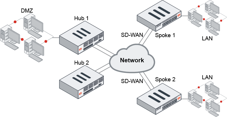

In this example, SD-WAN is configured with three members: vpn1, vpn2, and vpn3. Service rule 1 controls all traffic from 10.100.20.0/24 to 172.16.100.0/24 using member 1.
To send a duplicate of the traffic that matches service rule 1 using member 2, members 1 and 2 are added to the same SD-WAN zone, and a duplication rule is configured with service-id set to 1.
To send a duplicate of the traffic that matches service rule 1 using member 2:
