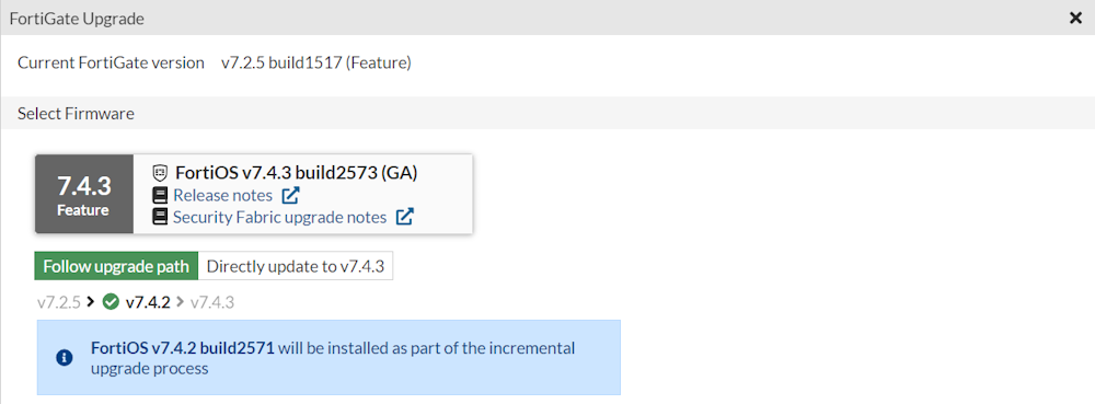

When the upgrade requires multiple builds in the upgrade path, you can choose to follow the upgrade path or to upgrade directly from the current version to the selected version.
When you follow the upgrade path, FortiGate automatically completes the upgrades, including any required reboots, by downloading the chosen firmware directly from FortiGuard. In this example, FortiGate automatically upgrades to each firmware in the upgrade path, which is 7.4.2 and then 7.4.3.

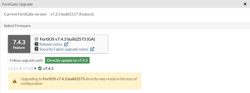

- If the selected firmware version spans multiple builds in the upgrade path, choose one of the following options:
Follow upgrade path
Automatically upgrade FortiGate to each firmware in the upgrade path before upgrade to the selected version. Recommended.
Directly update to v<version and build number>
Bypass the upgrade path to immediately upgrade FortiGate to the selected firmware. A warning message is displayed: Upgrading to FortiOS v<version and build number> directly may result in the loss of configuration.
