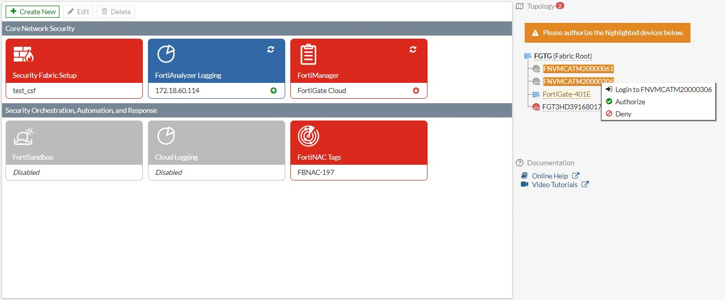

To authorize the FortiNAC on the root FortiGate in the GUI:
- Go to Security Fabric > Fabric Connectors.
- The FortiNAC device will be highlighted in the topology list in the right panel with the status Waiting for Authorization.
- Click on the highlighted FortiNAC and select Authorize.
Optionally, you can also deny authorization to the FortiNAC to remove it from the list.

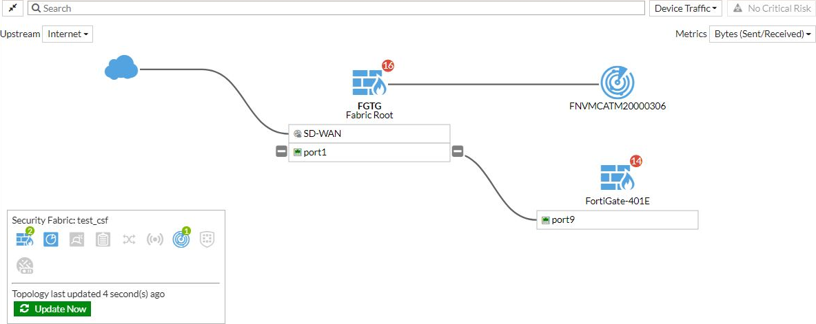

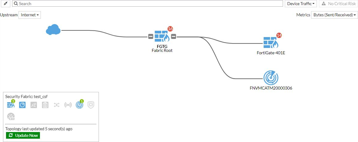

To verify the connection status:
- After the FortiNAC is authorized, go to Security Fabric > Physical Topology and confirm that it is included in the topology.
- Go to Security Fabric > Logical Topology and confirm the FortiNAC is also displayed there.

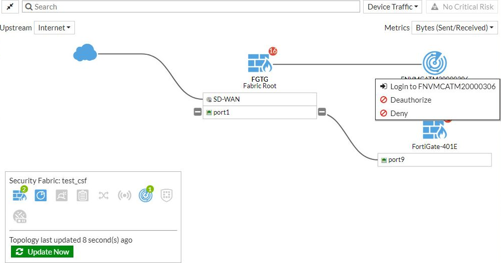

To log in to the FortiNAC from the FortiGate:
- On the FortiGate, go to Security Fabric > Physical Topology or Security Fabric > Logical Topology.
- Click on the FortiNAC and select Login to <serial_number>.
A new tab will open to the FortiNAC log in page.
- Enter the username and password to log in to the FortiNAC.
