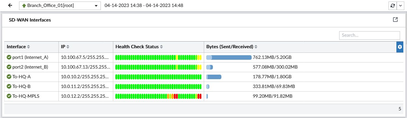

  1. Select a device in the list to display graphs of its details.
    By default, SD-WAN Monitoring History is disabled. When this feature is disabled, data for only the last 10 minutes is displayed. You can refresh to view the data directly from FortiGate devices. No historical data is stored in FortiManager when this feature is disabled.
    See also Enabling SD-WAN monitoring history.
  2. In 7.0 ADOMs and later, you can view realtime information for a specific device by selecting Every 30 Seconds, Every 1 Minute, or Every 3 Minutes from the Automatic Refresh dropdown menu. Only data from the past ten minutes is displayed when realtime refresh options are selected.
  3. Hover over the charts to view additional details.

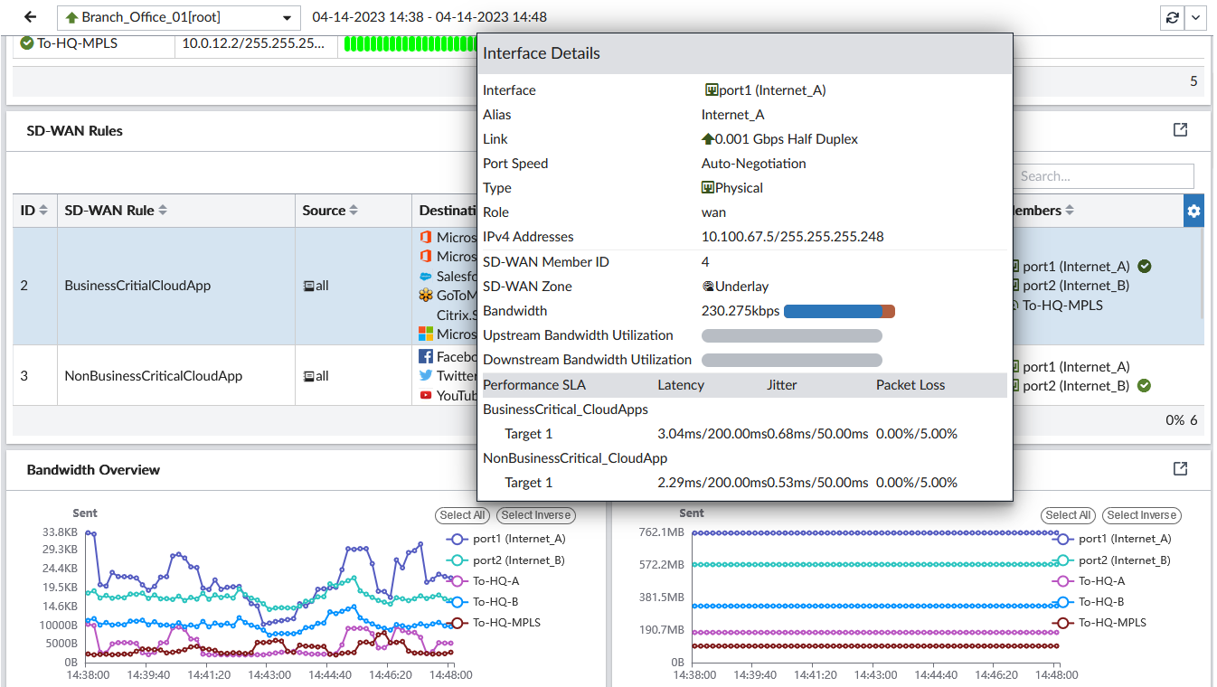

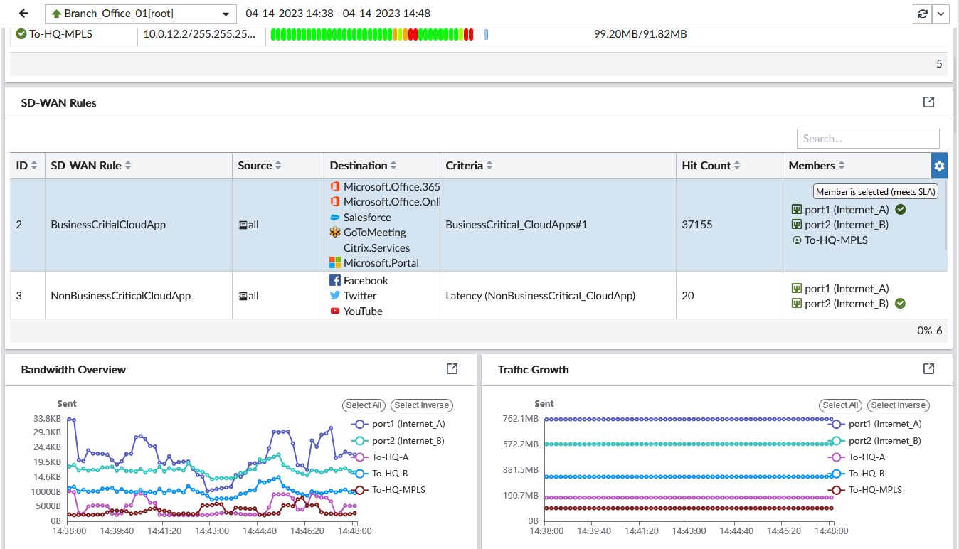

  4. The SD-WAN Rules widget includes the following features:
    • Rule statuses are indicated by color. Red interfaces indicate that the interface is down and the rule is inactive.
    • Active (referred to as selected) interfaces are identified with check mark icon in the SD-WAN Rules table. You can see why an interface is selected by hovering your mouse over the interface.
    • View interface statistics, including SLAs tied to that interface, upstream and downstream bandwidth, IP addresses, link speed, and more.
