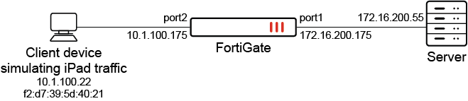

This topic contains two OT virtual patching examples: a basic configuration, and configuration that uses a NAC policy.
Example 1: basic configuration
This example demonstrates the flow for OT virtual patching from start to finish. First, a device (10.1.100.22) goes through device detection, which matches an OT detection signature downloaded on the FortiGate. Next, known vulnerabilities and OT patch signatures for this device are mapped to its MAC address. When traffic is generated by this device, IPS scans the traffic to identify any traffic patterns that match known OT patch signatures for this device. If a match is found, traffic is blocked by the FortiGate.
For demonstrative purposes, the simulated vulnerable OT device is a PC simulating web traffic from an iPad. An OT detection signature is specially crafted to match this Apple iPad traffic to the OT device category. To simulate vulnerable traffic, a test OT patch signature is used to match a generic cross-site scripting (XSS) attack over HTTP.

  1. Enable device detection on port2 :
    1. Go to Network > Interfaces and edit port2.
    2. In the Network section, enable Device detection.
    3. Click OK.

  3. Apply the virtual patching profile to a firewall policy for traffic from port2 to port1:
    2. In the Security Profiles section, enable Virtual Patching and select the virtual patch profile (test).
    3. Set SSL Inspection to a profile that uses deep inspection profile in order to scan SSL encrypted traffic.
    4. Configure the other settings as needed.
    5. Click OK.

To test the virtual patching:
  1. On the PC, generate traffic that simulates web traffic from an iPad. This traffic is generated in order for the FortiGate to perform device detection on port2. The OT detection signature 10000870 will be triggered, which considers this traffic from an OT device in this simulated scenario:
    # curl 172.16.200.55 -H "User-Agent: Mozilla/5.0 (iPad; CPU OS 12_5_5 like Mac OS X) AppleWebKit/605.1.15 (KHTML, like Gecko) Version/10.1.2 Mobile/15E148 Safari/604.1"

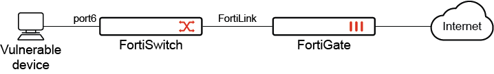

Example 2: NAC policy
In this example, a NAC policy is pre-configured to detect devices with information or higher vulnerabilities, as demonstrated in OT and IoT virtual patching on NAC policies. The NAC policy assigns the devices to vlan300.
A virtual patching profile is created to block any vulnerabilities with low, medium, high, or critical severity. The profile is applied to a firewall policy for outbound traffic.
