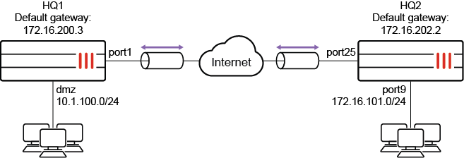

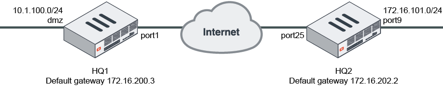

Basic site-to-site VPN with pre-shared key
This is a sample configuration of IPsec VPN authenticating a remote FortiGate peer with a pre-shared key.

To configure IPsec VPN authenticating a remote FortiGate peer with a pre-shared key using the CLI:
- Configure the WAN interface and default route. The WAN interface is the interface connected to the ISP. The IPsec tunnel is established over the WAN interface.
- Configure HQ1.
config system interface edit "port1" set vdom "root" set ip 172.16.200.1 255.255.255.0 next end config router static edit 1 set gateway 172.16.200.3 set device "port1" next end - Configure HQ2.
config system interface edit "port25" set vdom "root" set ip 172.16.202.1 255.255.255.0 next end config router static edit 1 set gateway 172.16.202.2 set device "port25" next end

- Configure the internal (protected subnet) interface. The internal interface connects to the corporate internal network. Traffic from this interface routes out the IPsec VPN tunnel.
- Configure HQ1.
config system interface edit "dmz" set vdom "root" set ip 10.1.100.1 255.255.255.0 next end - Configure HQ2.
config system interface edit "port9" set vdom "root" set ip 172.16.101.1 255.255.255.0 next end
