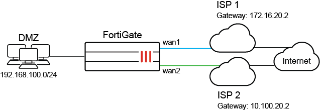

In this example, your wan1 and wan2 SD-WAN interfaces connect to two ISPs that both go to the public internet, and you want Gmail services to use the link with the least latency.

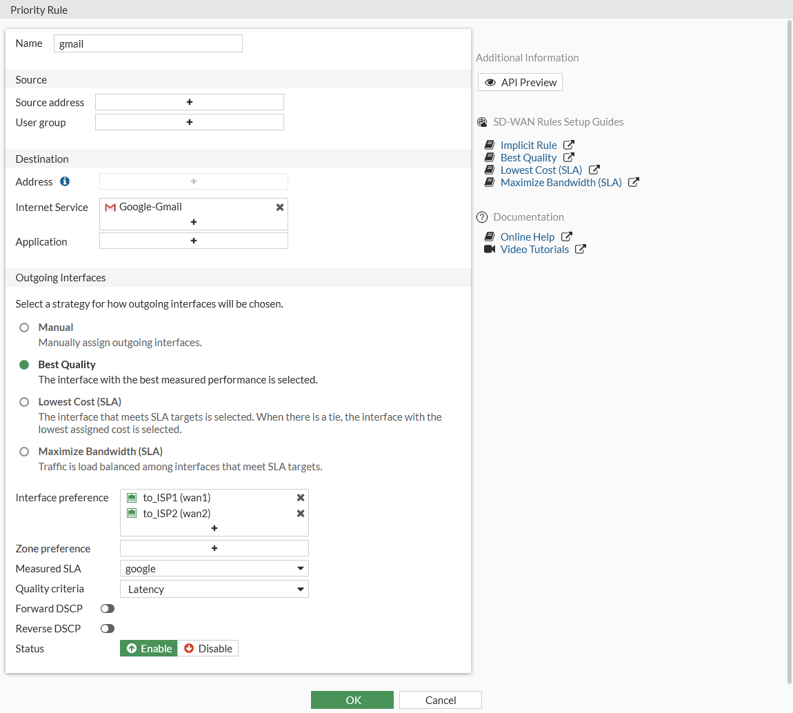

To configure an SD-WAN rule to use Best Quality:
On the FortiGate, add wan1 and wan2 as SD-WAN members, then add a policy and static route. See SD-WAN quick start for more details.
Go to Network > SD-WAN, select the Performance SLAs tab, and click Create New.
Enter a name for the performance SLA, such as google, and set the Server to google.com. See Health checks for more details.
Click OK.
Go to Network > SD-WAN, select the SD-WAN Rules tab, and click Create New.
Enter a name for the rule, such as gmail.
Configure the following settings:
Internet Service
Google-Gmail
Strategy
Best Quality
Interface preference
wan1 and wan2
Measured SLA
google
Quality criteria
Latency
Click OK.
