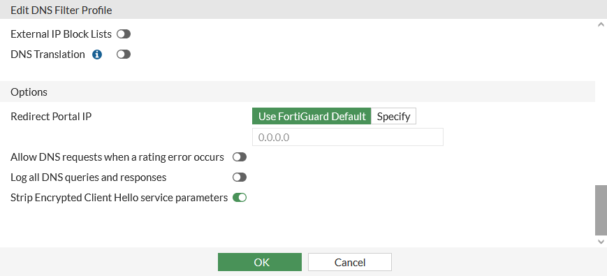

To configure stripping ECH information from DNS responses in the GUI:
  1. Go to Security Profiles > DNS Filter and edit an existing profile or click Create New.
  2. Enable Strip Encrypted Client Hello service parameters.
  3. Click OK.

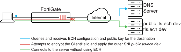

Blocking TLS connections with certificate inspection when ECH is used in the TLS handshake through the FortiGate
In this example, an SSL/SSH inspection profile is configured to block TLS connections from some SNIs when ECH is used in the TLS handshake. Client messages with the outer SNI public.tls-ech.dev are blocked.

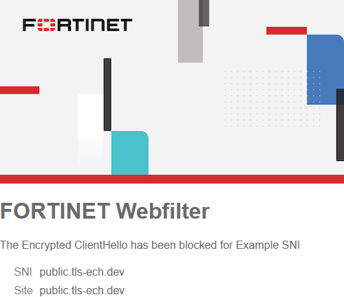

A webfilter block message will be shown when trying to connect directly to public.tls-ech.dev. Accessing the webpage tls-ech.dev, which uses public.tls-ech.dev in its outer SNI, will show that the client is not using ECH.

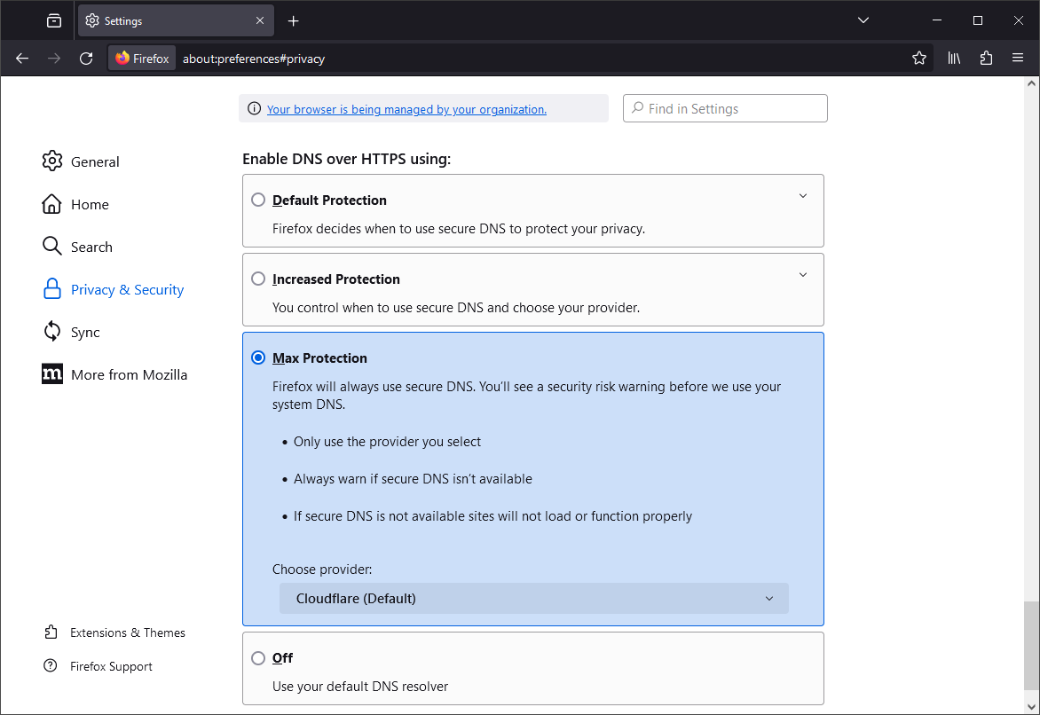

  1. In a browser, enable DNS over HTTPS. For example, in Firefox go to Settings > Privacy & Security and under DNS over HTTPS enable Max Protection.
  2. Visit a website, such as https://public.tls-ech.dev.
    Because ECH is blocked and the outer SNI matches one of the configured SNIs, the ECH initiated by the browser is blocked. In this case, the browser shows a replacement message:

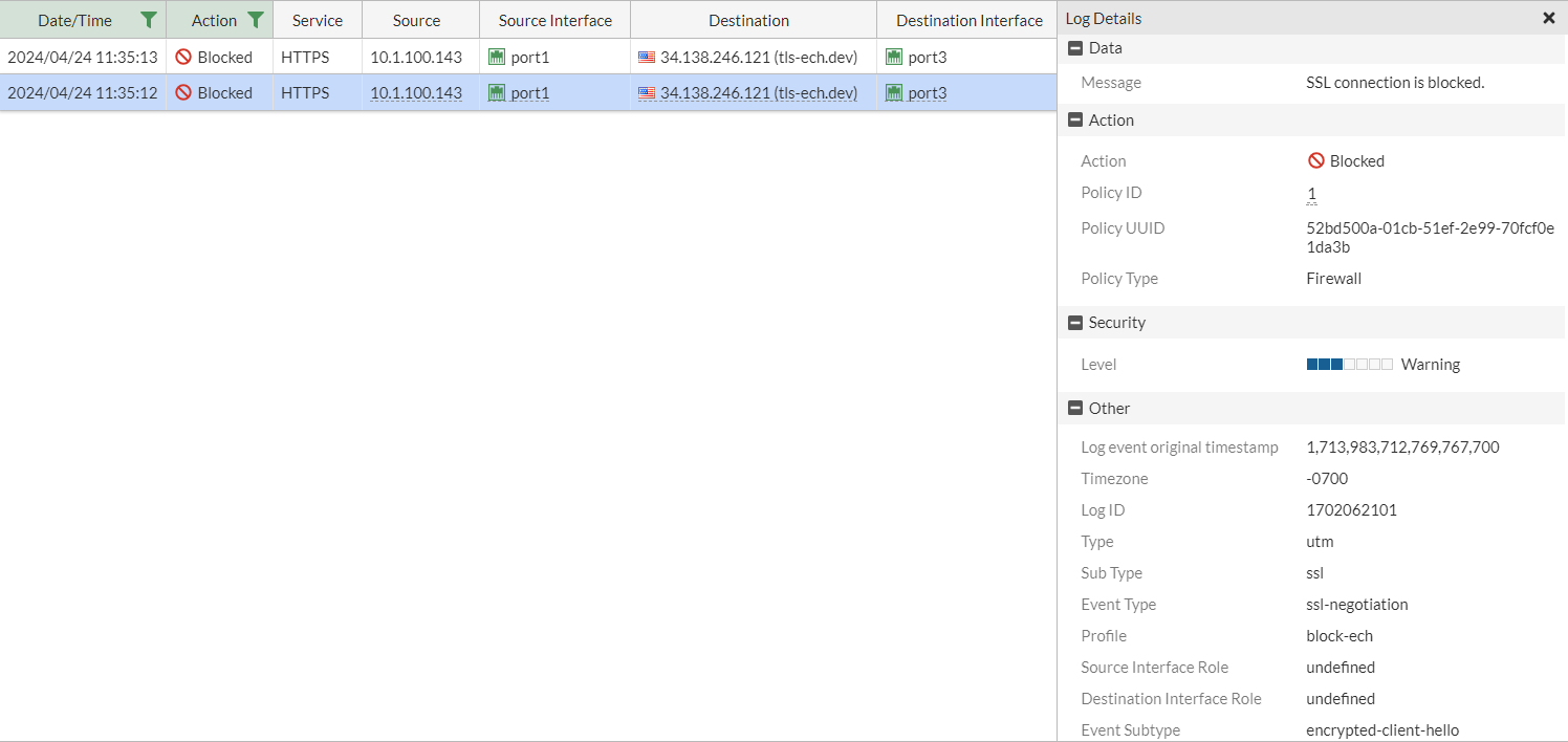

  3. An SSL log shows the blocked connection:
    2: date=2024-04-24 time=11:35:12 eventtime=1713983712769767807 tz="-0700" logid="1702062101" type="utm" subtype="ssl" eventtype="ssl-negotiation" level="warning" vd="vdom1" action="blocked" policyid=1 poluuid="52bd500a-01cb-51ef-2e99-70fcf0e1da3b" policytype="policy" sessionid=120849 service="HTTPS" profile="block-ech" srcip=10.1.100.143 srcport=63253 srccountry="Reserved" dstip=34.138.246.121 dstport=443 dstcountry="United States" srcintf="port1" srcintfrole="undefined" dstintf="port3" dstintfrole="undefined" srcuuid="fbd0def6-01ca-51ef-496f-08c90cb6b123" dstuuid="fbd0def6-01ca-51ef-496f-08c90cb6b123" proto=6 eventsubtype="encrypted-client-hello" hostname="public.tls-ech.dev" msg="SSL connection is blocked."

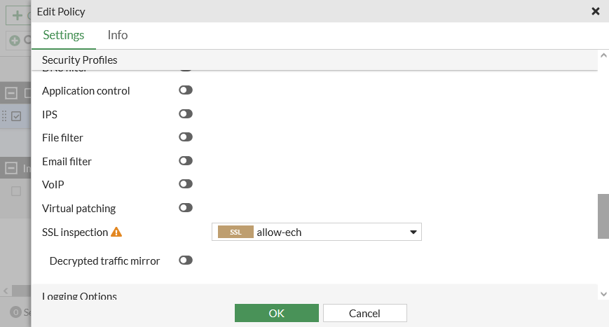

  5. Go to Policy & Objects > Firewall Policy and edit an existing policy or click Create New.
  6. Set SSL inspection to the SSL/SSH Inspection profile.

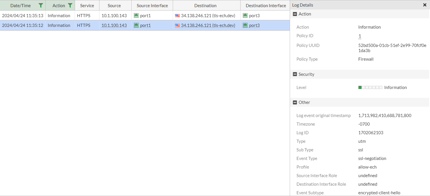

  3. An SSL log shows the allowed connection:
    2: date=2024-04-24 time=11:13:31 eventtime=1713982410688781760 tz="-0700" logid="1702062103" type="utm" subtype="ssl" eventtype="ssl-negotiation" level="information" vd="vdom1" action="info" policyid=1 poluuid="52bd500a-01cb-51ef-2e99-70fcf0e1da3b" policytype="policy" sessionid=118528 service="HTTPS" profile="allow-ech" srcip=10.1.100.143 srcport=63232 srccountry="Reserved" dstip=34.138.246.121 dstport=443 dstcountry="United States" srcintf="port1" srcintfrole="undefined" dstintf="port3" dstintfrole="undefined" srcuuid="fbd0def6-01ca-51ef-496f-08c90cb6b123" dstuuid="fbd0def6-01ca-51ef-496f-08c90cb6b123" proto=6 eventsubtype="encrypted-client-hello" hostname="public.tls-ech.dev"

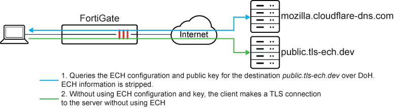

Stripping ECH information from DoH responses
DNS filters are used to strip ECH information from DNS responses, and force the browser to not use ECH for TLS connections. The browser relies on the ECH information from DNS over HTTPS (DoH) for ECH-enabled TLS connections.
In this example, a client sends a DoH query to a Cloudflare DNS server. The ECH information in the DNS response is stripped.
  1. Policy 3 performs deep inspection on DoH traffic between the browser and the DoH server (mozilla.cloudflare-dns.com). A DNS filter profile is applied that strips the ECH information from the DoH response, forcing the browser to use a non-ECH TLS connection.
  2. The browser then establishes a TLS connection through policy 1. Although policy 1 has an SSL/SSH inspection profile applied that allows ECH, ECH is not used because the ECH information from the DoH response was stripped by policy 3.

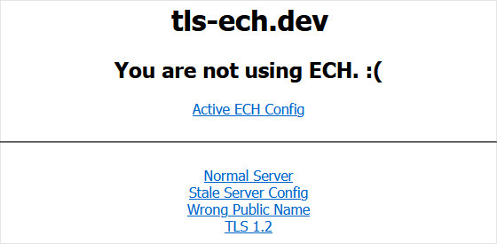

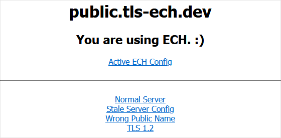

  4. In a browser, go to https://public.tls-ech.dev to see that ECH is not being used:
  5. The debug log will show that the ECH service parameter was removed:
  4. Try to visit a different website, such as tls-ech.dev, that does not match a default SNI to be blocked. The browser will initially try to establish an ECH-enabled TLS connection to public.tls-ech.dev, but that will be blocked, forcing the browser to connect to the actual website without ECH. In this case, the browser will load the actual website and not the replacement message:

To configure allowing a TLS connection that uses ECH in the GUI:
  1. Go to Security Profiles > SSL/SSH Inspection and edit an existing profile or click Create New.
  2. Set Inspection method to SSL Certificate Inspection.
  3. Set Encrypted Client Hello to Allow.
  4. Click OK.
  7. Click OK.

To check the results:
    The ECH-enabled TLS connection is allowed through the firewall policy and the website opens:

  1. Configure the DNS filter profile that removes the ECH information:
    config dnsfilter profile
        edit "strip-ech-enable"
            set strip-ech enable
    # diagnose debug application dnsproxy -1
    [worker 0] dns_secure_filter_ech()-2166: Found ECH key=5
    [worker 0] dns_secure_filter_ech()-2203: Removed ECH service parameter
