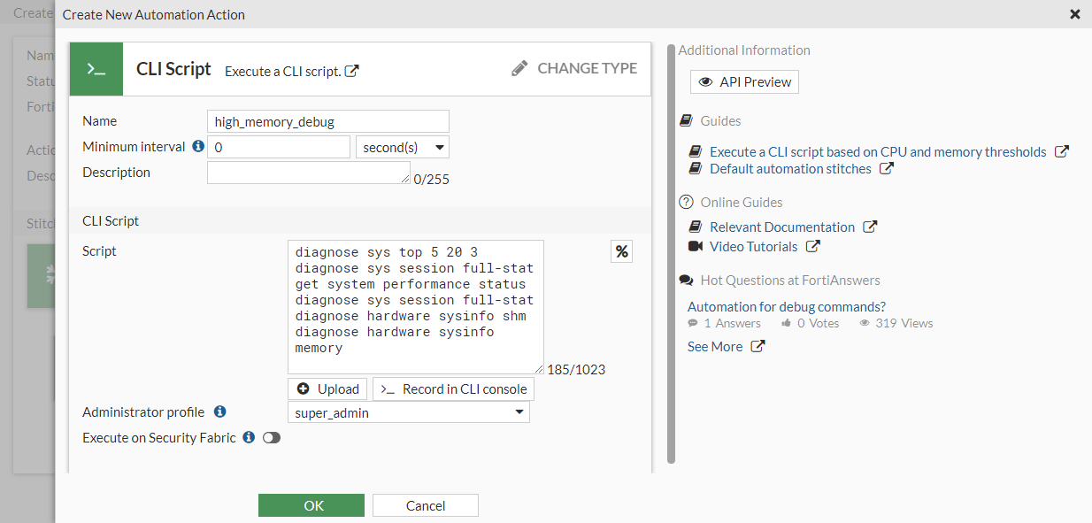

- Configure the CLI Script action:
- Click Add Action.
- Click Create and select CLI Script.
- Enter the following:
Name
high_memory_debug
Script
diagnose sys top 5 20 3 diagnose sys session full-stat get system performance status diagnose sys session full-stat diagnose hardware sysinfo shm diagnose hardware sysinfo memory
Administrator profile
Select a profile
- Click OK.

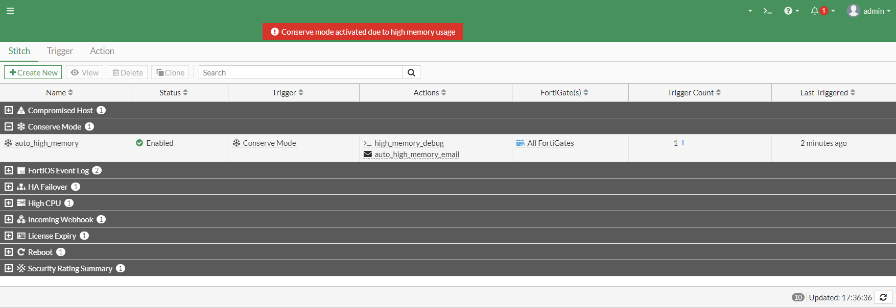

Results
When the FortiGate enters conserve mode due to the memory-use-threshold-red being exceeded, the GUI displays a notice, and the auto_high_memory automation stitch is triggered. This causes the CLI script to run and the script results are emailed to the specified address.
