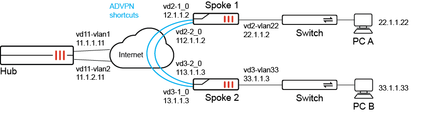

In this example SD-WAN is configured between one hub and multiple spokes, and the SD-WAN configuration shows SD-WAN rule 3 with the following required settings to enable spoke-to-spoke traffic between multiple ADVPN shortcuts:
  • set load-balance enable
  • set tie-break fib-best-match

To trigger spoke-to-spoke communication, run an ICMP ping on PC A with IP address 22.1.1.22 behind spoke 1 that is destined for PC B with IP address 33.1.1.33 behind spoke 2. The spoke-to-spoke traffic will be used to demonstrate load balancing between shortcuts in the CLI output of this topic.
To verify the configuration:

  6. Check the sniffer packet output after changing the setting to set tie-break fib-best-match.
    The following packet sniffer output of ICMP pings demonstrates how load balancing of spoke-to-spoke is limited and only occurs between shortcuts vd2-1_0 and vd2-2_0, which are within SLA.

  7. Check SD-WAN health.
    When an ADVPN shortcut is out of SLA, traffic does not run on it. Shortcut vd2-1_0 is out of SLA.

  8. Check the sniffer packet:
    No traffic runs on Shortcut vd2-1_0 because it is out of SLA.
