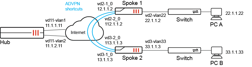

Example
In this example SD-WAN is configured between one hub and multiple spokes, and the SD-WAN configuration shows SD-WAN rule 3 with the following required settings to enable spoke-to-spoke traffic between multiple ADVPN shortcuts:

To trigger spoke-to-spoke communication, run an ICMP ping on PC A with IP address 22.1.1.22 behind spoke 1 that is destined for PC B with IP address 33.1.1.33 behind spoke 2. The spoke-to-spoke traffic will be used to demonstrate load balancing between shortcuts in the CLI output of this topic.
