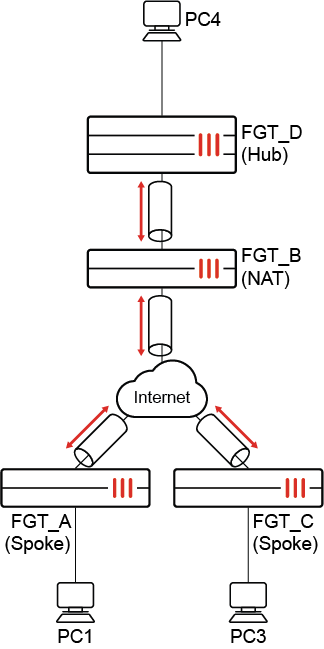

Example
In this example, IPsec VPN crosses over a carrier network and UDP packets are not allowed.
To encapsulate ESP packets within TCP headers:

  3. Configure the FGT_A (spoke) FortiGate.

  4. Configure the FGT_C (spoke) FortiGate.

  5. Configure the FGT_D (hub) FortiGate.

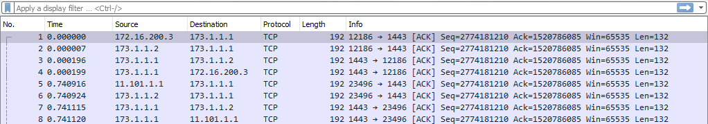

  7. Verify the ESP packets sniffed on the NAT device.
    In the packet capture, ESP packets are encapsulated into TCP ACK packets with the same sequence number. This is why anti-replay must be disabled on the NAT FortiGate.

      IKE and ESP will be encapsulated into TCP, and ESP packets encapsulated into a non-standard TCP header.

      IKE will use UDP encapsulation first. If it fails to establish in 10 seconds, it will fall back to TCP. ESP packets are encapsulated into a non-standard TCP header.
