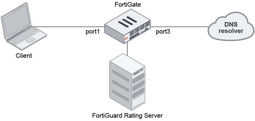

In the following examples, the FortiGate inspects DNS queries made over DoT and DoH to a Cloudflare DNS server. The DNS filter profile blocks the education category.

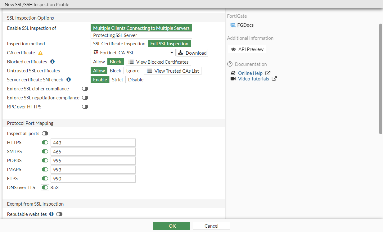

- Configure the SSL-SSH profile:
- Go to Security Profiles > SSL/SSH Inspection and click Create New.
- Set Inspection method to Full SSL Inspection. DoT and DoH can only be inspected using doing deep inspection.
- In the Protocol Port Mapping section, enable DNS over TLS.
- Configure the other settings as needed.
- Click OK.

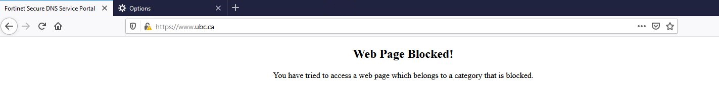

To query DNS over HTTPS:
- In your browser, enable DNS over HTTPS.
- Go to www.ubc.ca. The website is redirected to the block page.
