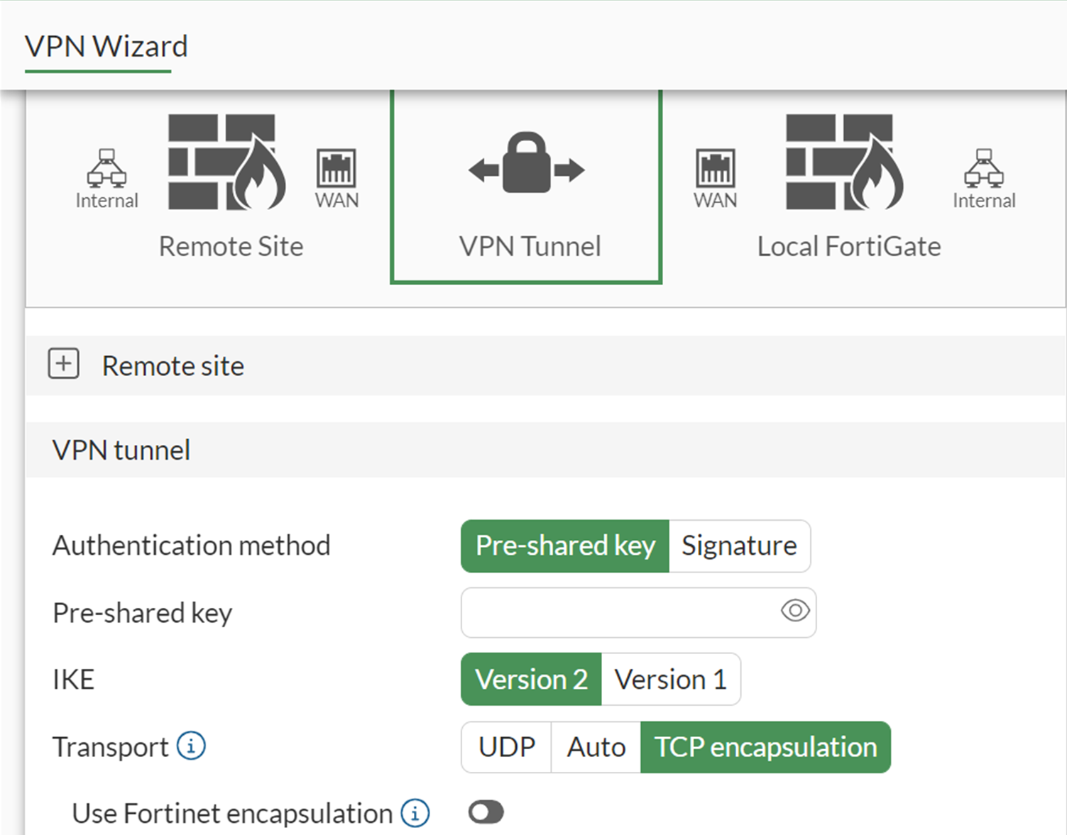

In the GUI, the VPN Wizard can be used to set the IKE transport protocol.
To set the IKE transport protocol in the GUI:
  1. Go to VPN > VPN Wizard.
  2. Enter a Tunnel name.
  3. For Select a template, select Site to Site, and click Begin.
  4. Configure the Remote Site settings as required, and click Next.
  5. Under VPN tunnel, set the Transport protocol as needed.
    The Use Fortinet encapsulation option displays only when Transport is set to TCP encapsulation. See Encapsulate ESP packets within TCP headers for more information.
    When Transport is set to Auto, you can adjust the threshold for switching to TCP encapsulation by using the set auto-transport-threshold command.
  6. Configure the remaining settings as needed.

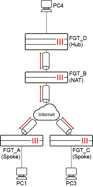

In this example, IPsec VPN crosses over a carrier network and UDP packets are not allowed.
To encapsulate ESP packets within TCP headers:
  1. On each FortiGate, configure the IKE TCP port setting:

  3. Configure the FGT_A (spoke) FortiGate.

  4. Configure the FGT_C (spoke) FortiGate.

  5. Configure the FGT_D (hub) FortiGate.

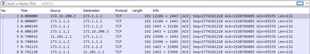

  7. Verify the ESP packets sniffed on the NAT device.
    In the packet capture, ESP packets are encapsulated into TCP ACK packets with the same sequence number. This is why anti-replay must be disabled on the NAT FortiGate.

    2. Configure the IPsec phase 2 settings:
          edit "spoke"
              set phase1name "spoke"
              set proposal aes128-sha1 aes256-sha1 aes128-sha256 aes256-sha256 aes128gcm aes256gcm chacha20poly1305
              set src-subnet 10.1.100.0 255.255.255.0
      IKE and ESP will be encapsulated into TCP, and ESP packets encapsulated into a fake TCP header.
    1. Configure the IPsec phase 1 settings:
          edit "Spoke"
              set interface "wan1"
              set ike-version 2
              set peertype any
              set net-device disable
              set proposal aes128-sha256 aes256-sha256 aes128gcm-prfsha256 aes256gcm-prfsha384 chacha20poly1305-prfsha256
              set transport auto
              set fortinet-esp enable
              set auto-transport-threshold 10
              set remote-gw 173.1.1.1
              set psksecret **********
          edit "Spoke"
              set phase1name "Spoke"
              set src-subnet 192.168.4.0 255.255.255.0
      IKE will use UDP encapsulation first. If it fails to establish in 10 seconds, it will fall back to TCP. ESP packets are encapsulated into a fake TCP header.
          edit "Hub"
              set type dynamic
              set interface "port25"
              set ike-version 2
              set peertype any
              set dpd on-idle
              set transport tcp
              set dpd-retryinterval 60
          edit "Hub"
              set phase1name "Hub"
